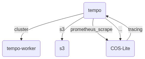

Monolithic deployment mode for testing and dev
To deploy Tempo HA in monolithic mode, where a single worker node runs all components of distributed Tempo, you need to deploy a single instance of the tempo-coordinator-k8s charm as tempo and a single instance of the tempo-worker-k8s charm as tempo-worker.
Integrate them over cluster and integrate the tempo application with s3. At that point tempo should go to active status.

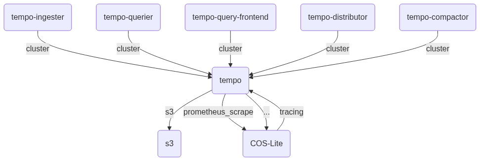

Add dedicated worker roles
You can turn the monolithic deployment you have now in a distributed one by assigning some or all Tempo roles to individual worker units. See this doc for an explanation of the architecture, and this document for reference of the tempo roles. For Tempo to work, each one of the required roles must be assigned to a worker. This requirement is trivially satisfied if a worker has the role all.
So, without removing the tempo-worker application, we are going to start by adding an ingester worker node. Deploy another instance of the tempo-worker-k8s charm as tempo-ingester and add it to the same tempo coordinator instance to have it join the cluster. Configure the ingester application, as you deploy it or afterwards, to only have the ingester role enabled.
code
juju deploy tempo-worker-k8s --channel edge --trust tempo-ingester --config role-all=false --config role-ingester=true
juju integrate tempo tempo-ingester
Wait for the worker to go to active. Now you have two worker nodes running the ingester component, and one node also running all other components.
Repeat the above step for all other required roles: querier, query-frontend, distributor, compactor, and when you’re done, remove the tempo-worker application. Each of the required roles initially taken by the tempo-worker application has now been transferred to the new worker instances.
