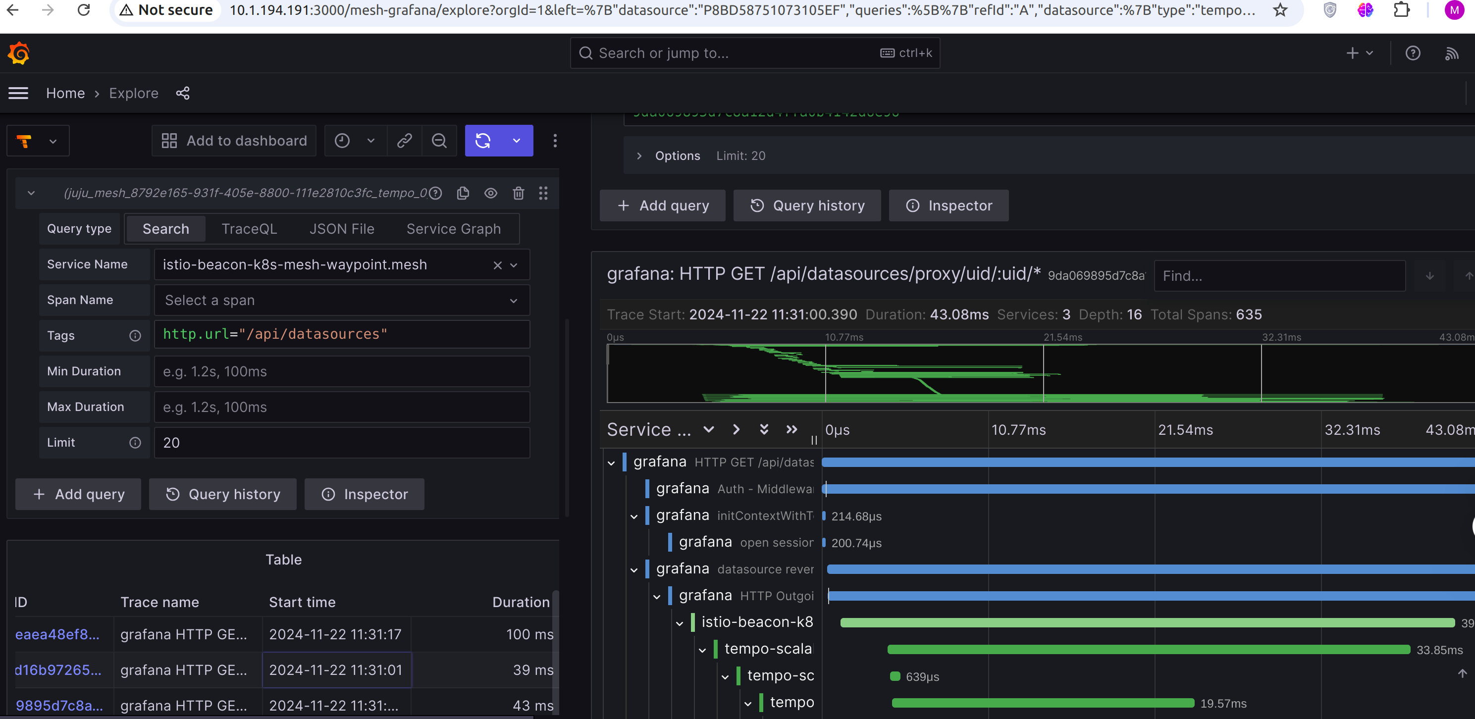

Visualize traces in Grafana
Open Grafana web UI form your local web browser and login using the admin password.
Then, Toggle Menu → Explore → Choose your Tempo datasource
This should result in an output similar to the one below:
As expected in Istio’s ambient mode, mesh traces are generated in the L7 layer by the waypoint proxy (i.e istio-beacon-k8s), so you’d find traces generated under istio-beacon-k8s-mesh-waypoint.mesh service name.
Stitching spans together
By design, Istio will not propagate trace headers, so it would be the workload’s responsibility to propagate the trace headers.
Charmed Istio will generate and export traces using OpenTelemetry protocol and therefore, if a charmed workload on the mesh is already instrumented to propagate OpenTelemetry headers, Tempo would stitch together spans generated from that workload with the one generated by its waypoint proxy along with any other workloads that are instrumented in the same manner as you can see in the screenshot above.
