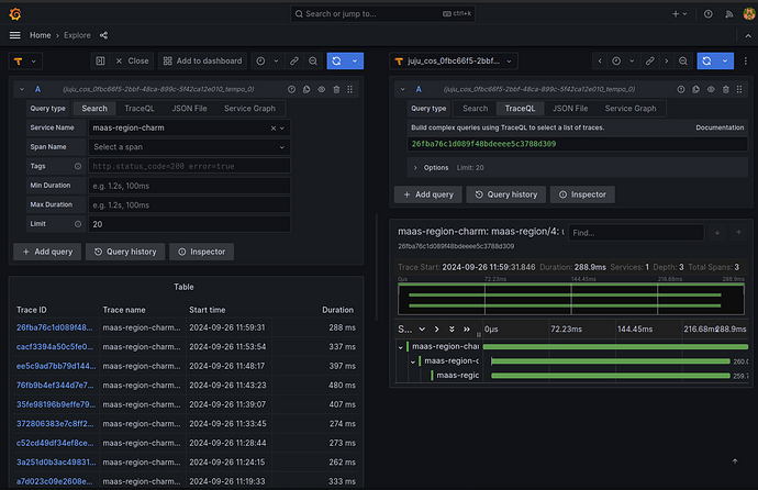

Visualize traces in Grafana
To view the traces of the MAAS region charm:
- Open Grafana in your browser (see here for detailed instructions)
- Go to the
Exploretab - Select the Tempo datasource
- Select the
Searchquery type - Pick
maas-region-charmas the service - Query it!
You should now see a list of traces from the charm. You can inspect them by clicking on a trace ID. Here is a sample screenshot:
