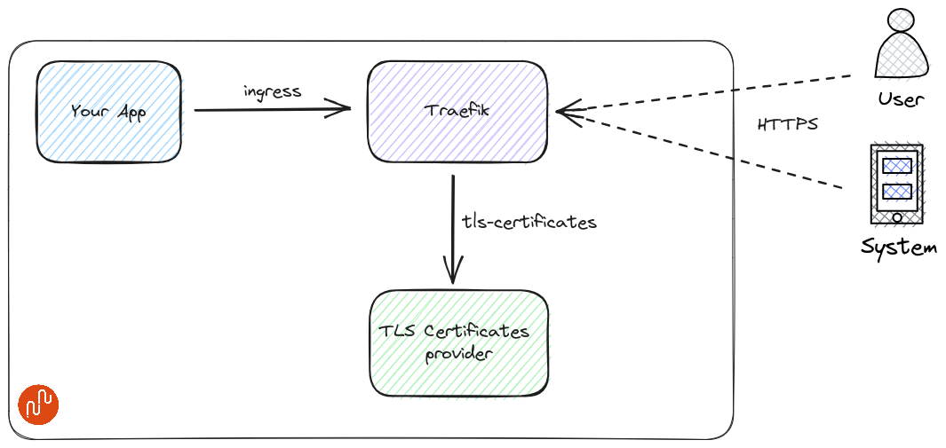

Question 1: Where should your TLS connection be terminated?
At the ingress level
In contexts where X.509 certificates are necessary to ensure HTTPS communication with users or systems outside of the Juju model where the application is deployed, it is recommended to use an ingress controller like Traefik. Traefik handles TLS connection termination, sending decrypted data to your application, so your application charm does not need to manage X.509 certificates. Implementing the ingress integration is all that’s required as Traefik already supports the tls-certificates interface.

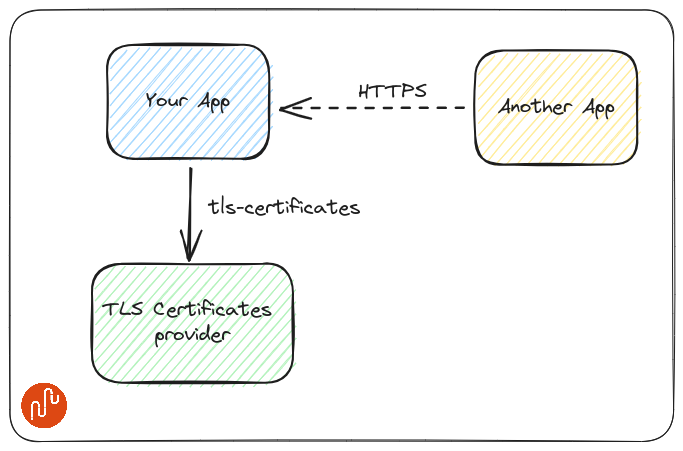

At the application level
For use cases where HTTPS communication is done inside of the Juju model, TLS connections will need to be terminated at the application level. This requires implementing the requirer side of the tls-certificates-interface in your charm. A typical example is enabling various units of a PostgreSQL cluster to communicate via TLS.
The upcoming questions will help you choose the most appropriate TLS provider for a TLS connection terminated at application level.
