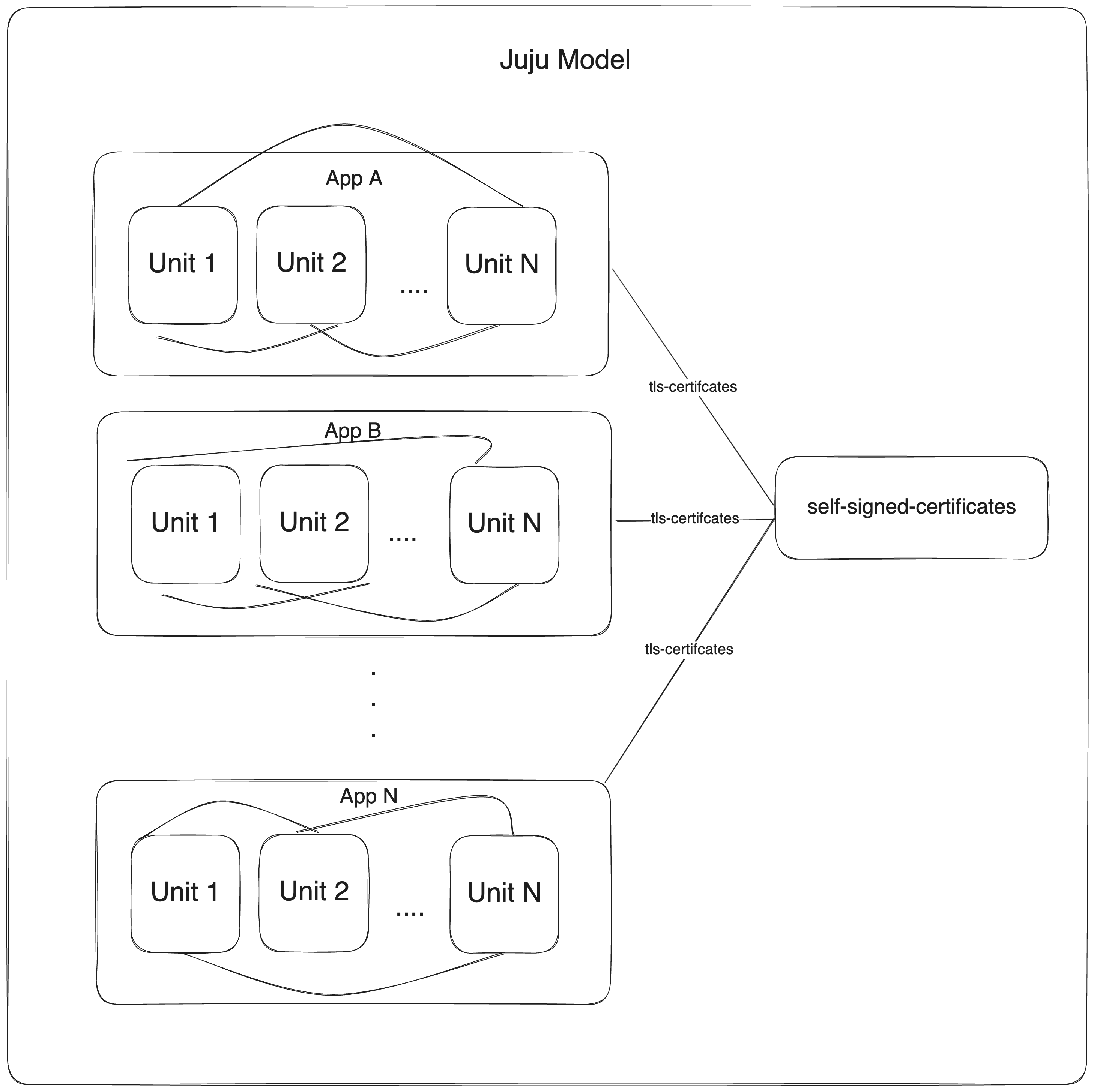

When deploying multiple applications in a Juju model that require TLS for internal communication (e.g., between the units of the same application), we recommend using the self-signed-certificates charm.
Integrate each application with self-signed-certificates over the tls-certificates interface in UNIT mode. This ensures that each unit receives its own unique certificate.
The self-signed-certificates charm will issue a Certificate object for each unit, containing:
  • Signed leaf certificate for that specific unit.
  • CA certificate that signed the leaf certificate.
  • Certificate chain in the form: [Signed Leaf Certificate, CA Certificate].
