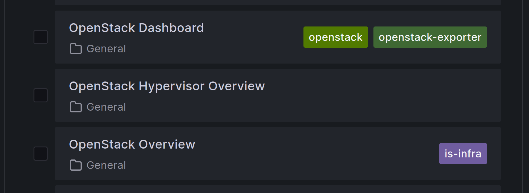

View the Grafana dashboards
Navigate to the Grafana web ui and click the dashboards tab. Under the “General” folder, you should see the three dashboards:
See the Grafana Dashboards section of the docs for more information about the provided dashboards.
