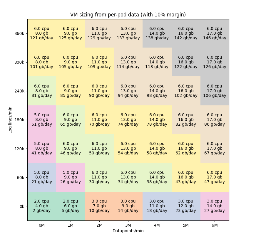

Note that the results above do not leave any leeway. For production you should probably use >10% margin.
When COS Lite is in isolation and is only ingesting its own self-monitoring metrics (“idle” mode), it consumes 6% CPU (0.48 vCPU) and 16% memory (2.56 GB).
To calculate dynamically, use:
disk = 3.011e-4 * L + 3.823e-6 * M + 1.023
cpu = 1.89 * arctan(1.365e-4 * L) + 1.059e-7 * M + 1.644
mem = 2.063 * arctan(2.539e-3 * L) + 1.464e-6 * M + 3.3
Where:
- disk is in GiB/day
- cpu is in vCPUs
- mem is in GB
- L is the number of ingested log lines per minute
- M is the number of ingested metric datapoints per minute

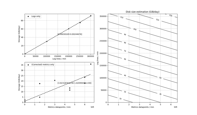

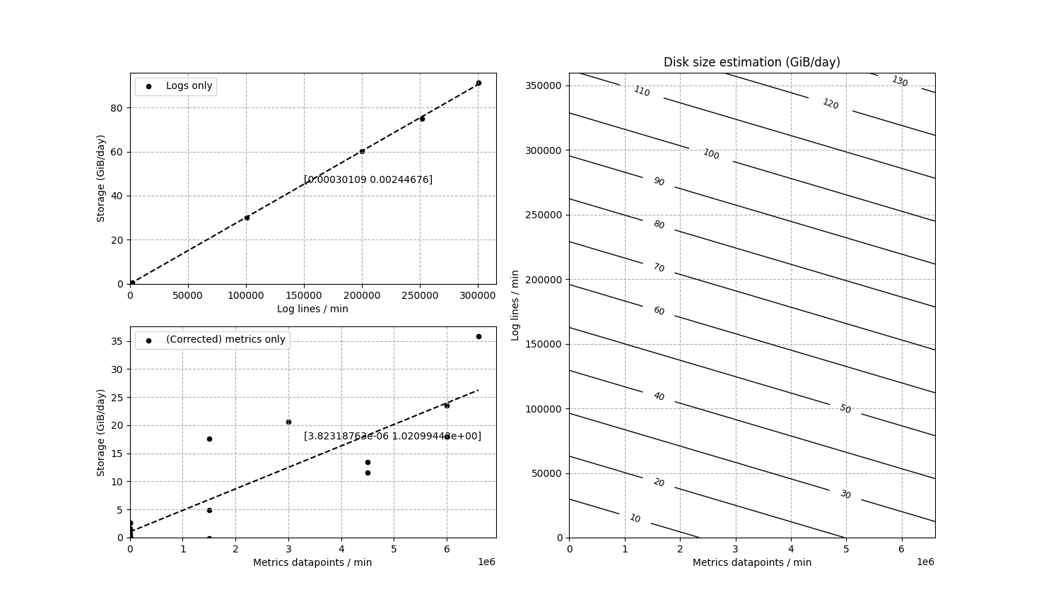

Disk usage
- Disk usage as a function of logs ingestion rate has an excellent linear fit. The fit was made using data from Loki 2.9.2 only, using a 12h average.
- The data spread for metrics ingestion rate isn’t great, and may be due to a human error of inconsistent recording of 6h vs 12h averages (I switched from 6 to 12h during the experiment). The linear fit gives good coverage for high ingestion rates. More accurate results will be published soon after refactoring the load test.
- Disk usage (GiB/day) can be calculated as follows:
(3.011e-4 * L + 2.447e-3) + (3.823e-6 * M + 1.021), whereLis the number of log lines per minute, andMis the number of metrics data points per minute. The time scale of1mwas chosen to match the default scrape interval of charmed prometheus. Self-monitoring contributes the1.021(GiB/day) to the overall usage. The2.447(MiB/day) is likely just a minor fitting error (effectively equals zero).

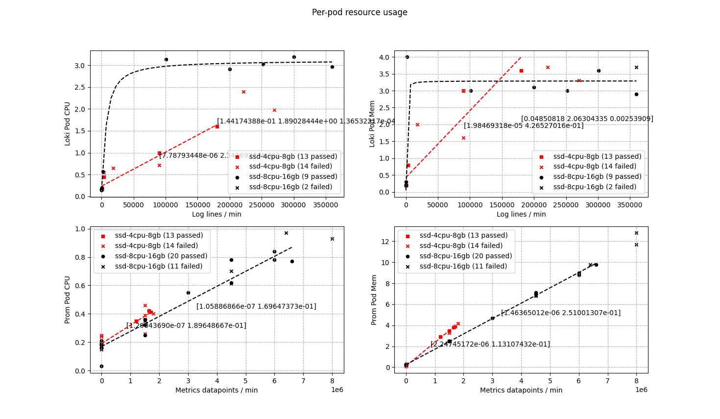

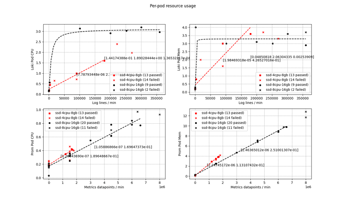

Per-pod resource usage
- Per-pod resource usage is interesting because it gives better insight into how compute resources are consumed across components.
Loki
- Ingestion load is negligible to query load. That is why resources saturate at the same level for a broad range of ingestion rate.
- The difference in trend between the current experiment (8cpu16gb) and the previous experiment (4cpu8gb) can be explained by:
- Different Loki configuration.
- Different Loki version (more memory efficient).
- For some reason that is currently unknown to me, Charmed Loki wasn’t able to ingest more than 360k log lines per minute, even though VM resources were not exhausted. This is likely to do with a Loki configuration option that I haven’t discovered yet.
- For fitting purposes, the
arctanfunction was used in order to capture the behaviour near the origin. The choice ofarctanis arbitrary. - Resource usage calculation (
Lis the number of log lines per minute):- CPU usage (vCPUs):
1.442e-1 + 1.89 * arctan(1.365e-4 * L) - Memory usage (GB):
4.851e-2 + 2.063 * arctan(2.539e-3 * L)
Prometheus
- Total load is strongly linear with ingestion rate, indicating that querying is cheaper than ingestion.
- The difference in trend between the current experiment (8cpu16gb) and the previous experiment (4cpu8gb) can be explained by the different Prometheus version used, which included improvements in memory and cpu usage.
Mis the number of metric data points per minute):- CPU usage (vCPUs):
1.059e-7 * M + 1.696e-1 - Memory usage (GB):
1.464e-6 * M + 2.51e-1
