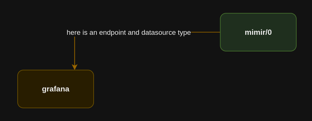

The grafana_datasource interface is meant for applications such as Mimir to register themselves with grafana as datasources, so that grafana (and dashboards in particular) can query them to surface useful information to the end user.
As soon as it receives a datasource configuration, grafana assigns to it an internal UID. So if we want to configure Mimir to use a certain Tempo datasource for cross-referencing metrics generated from the traces, we must give Mimir Tempo’s datasource UID. So the first step for getting this to work is to use the grafana_uid field exposed by the grafana_datasource interface.
