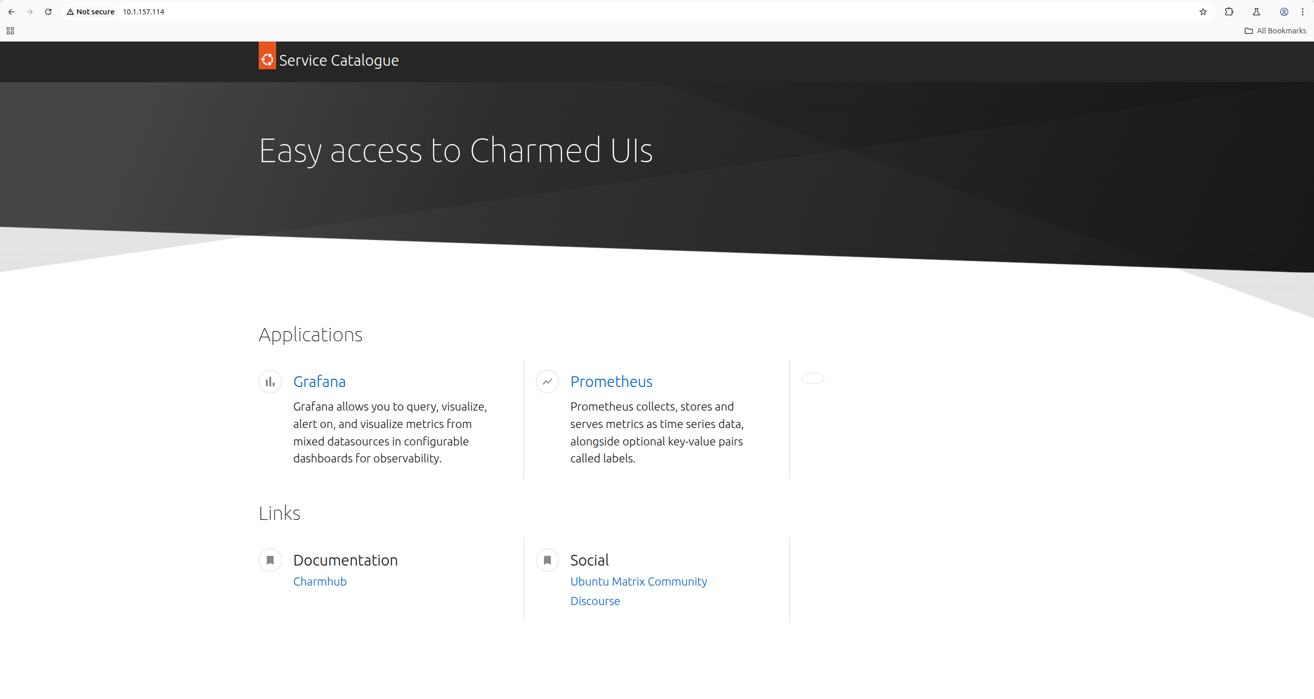

  • A strange oval (very faint) appears near the top right of the applications list (see screenshot at the bottom)
