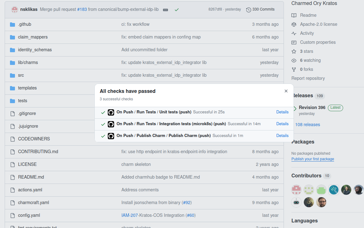

  • Tests results - for me the results from the latest commit CI are perfectly fine, but I am not sure if we are expected to provide something else. Let’s wait for @varshigupta to reply.
  • Documentation for usage: maybe you could link the Getting started guide? It will take users directly to the place they need. I understand that it doesn’t really make sense to deploy Kratos alone, so the docs for usage can be the whole bundle deployment. Could you please confirm this understanding?
Yes, the reason for not having individual docs for each component is that it makes no sense to deploy Kratos on its own (to be precise maybe it may make sense in some cases BUT we don’t care to cater to them).
Just to be sure I understand, can we keep the docs as they are? If there are no major issues, I would rather we keep them as they for now. (they have been reviewed by the docs team and we can always improve on them after the charms have been published).
@dnplas Checking the last actions run is a good approach for unit and integration tests in this case. Usually, the team provides a link to the actions run to review.
