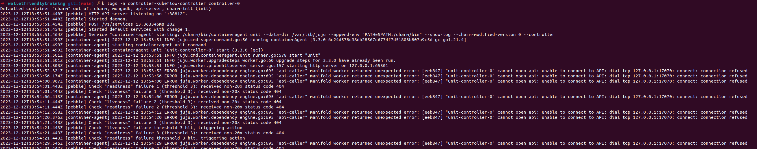

All is working well until I restart my AKS (or doing nothing for like 20minutes), then I can’t do anything except juju controllers
When I’m looking at the controller logs I get:
You appear to have defaulted to the charm container on the last logs screenshot. It shows that you can’t connect to the controller API.
