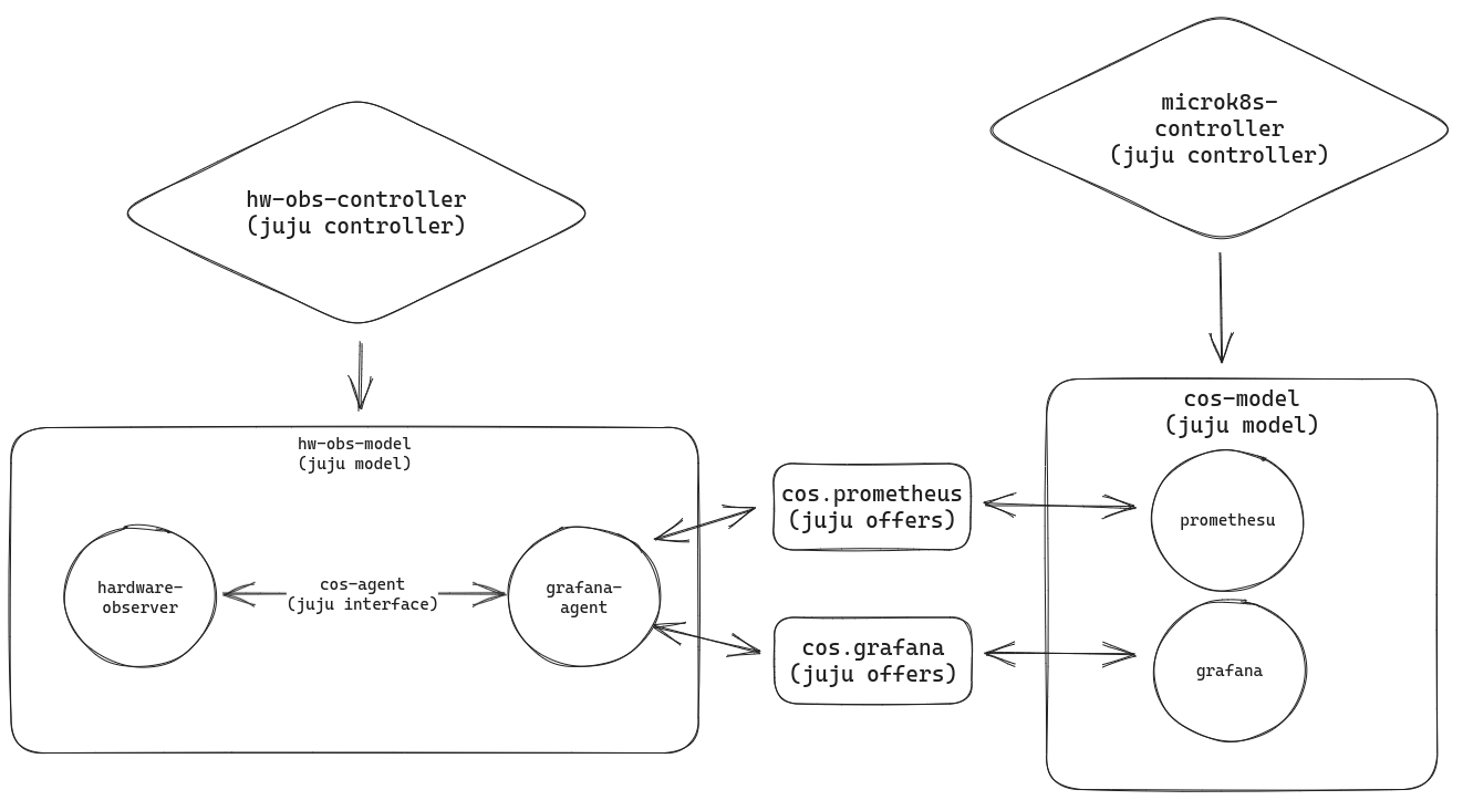

Then add the necessary relations with the grafana-agent charm.
# add cross-model relations
juju relate grafana-agent cos.prometheus-receive-remote-write
juju relate grafana-agent cos.grafana-dashboards
juju relate grafana-agent cos.loki-logging
Now the architecture looks like below:
