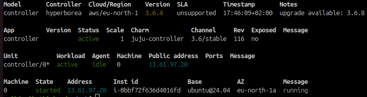

I am trying to upgrade a juju cluster from 3.6.4 → 3.6.8
juju upgrade-controller
ERROR cannot upgrade to "3.6.8" due to issues with these models:
"jandersson/ws-monitoring":
- model is under "importing" mode, upgrade blocked
