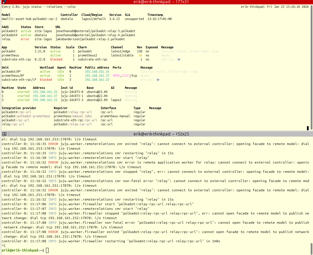

One example, is a model that is consuming a remote controller relation (saas). The controller is since long removed, so it not responsive at its ip-address.
This is how it looks:
The removed controller (192.168.161.252:17070) throws ERROR in the logs. (The controller was a 3 node controller-ha, so there are some more IP:s in the logs as you can see)
Running: “juju remove-saas relay –force –no-wait” just does nothing and no change in the logs.
I suspect we need to do database surgery on this? Similar, and perhaps related to our situation here.
We really would need to be able to break out of this as it is causing side effects for us in terms of being able to add/remove/change the model. Redeployment is not an option we prefer as there are lots of manual and risk involved in such a migration.
