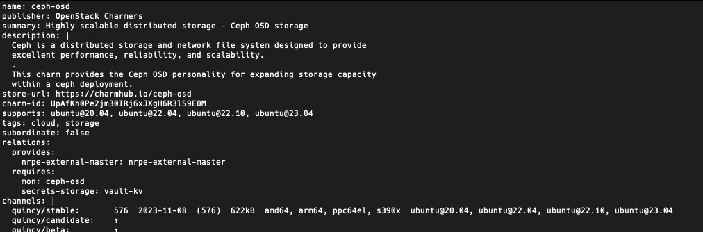

juju info ceph-osd clearly states that it’s possible (see attachment)

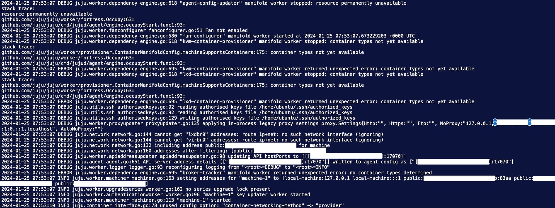

Nothing really interesting on my 23.04 machine itself:
While the controller logs have this:
