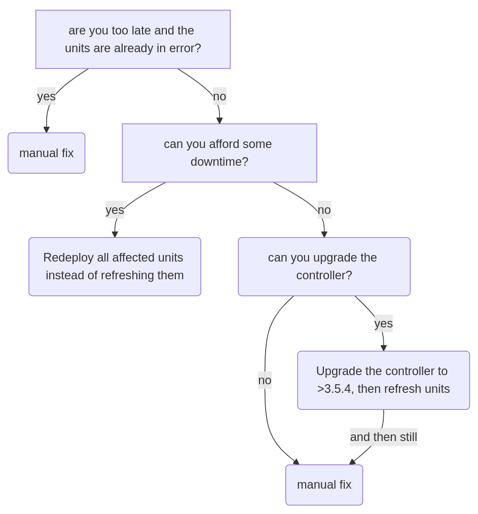

The issue: during refresh, juju didn’t properly wipe the virtualenv the charm shipped with. Consequently, some python packages making use of dark importlib sorcery break on import (that is, before the charm has a chance to even run).
The cure(s) :pill:
Depending on how hardcore your environment is, the following solutions will apply.
[mermaid source]
flowchart TD
    Z[are you too late and the units are already in error?] -->|yes| Y(manual fix)
    A[can you afford some downtime?] -->|yes| B(Redeploy all affected units instead of refreshing them)
    Z -->|no| A
    A -->|no| C(can you upgrade the controller?)
    C --> |yes| D(Upgrade the controller to >3.5.4, then refresh units)
    C --> |no| E(manual fix)
    D --> |and then still| E(manual fix)
The manual fix :hammer_and_wrench:
For a charm already deployed with an affected Juju version, upgrading the Juju controller or Juju unit version will not clean up the empty directories that already exist inside the charms. Applying this manual fix will ensure that future deployments do not introduce new empty directories.
Strategy one
Manually wipe empty dirs from the charm sources on the affected juju units.
juju exec --application the-charm "find /var/lib/juju/agents/unit-*/charm -type d -empty -delete"
Strategy two
Manually trigger the built-in patch in charm code.
The first thing you should try is check whether the latest revision of the charm (from edge) contains the patch that works around this issue. If so, it may be enough to refresh to that revision and ensure the charm can process the upgrade-charm hook.
If the charm was in error state before you attempted the refresh, juju won’t let it proceed to see that hook. All you can do in this case is skip ahead with juju resolve --no-retry until it hits upgrade-charm, then the patch should be applied and things fixed.
A hackier but quicker solution is to jhack fire myunit upgrade-charm and directly trigger the patch code.
