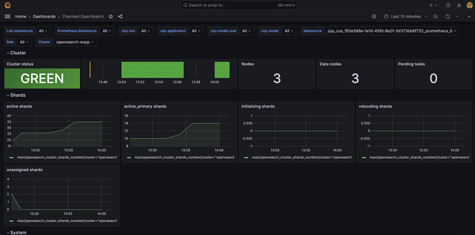

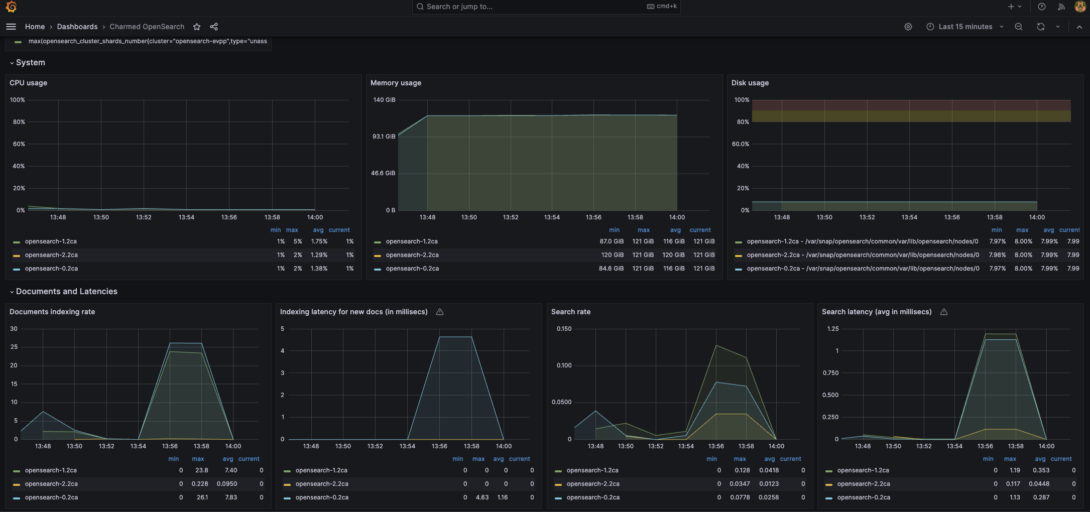

After accessing Grafana web interface, select the “Charmed OpenSearch” dashboard.
The dashboard filters for juju-specific elements, e.g. application name, unit, model; and also OpenSearch’s cluster and roles. The cluster dropdown allows to select which cluster we want to see the statistics from:
It is also possible to select a subset of nodes following roles. That can select nodes across models or applications as well.
