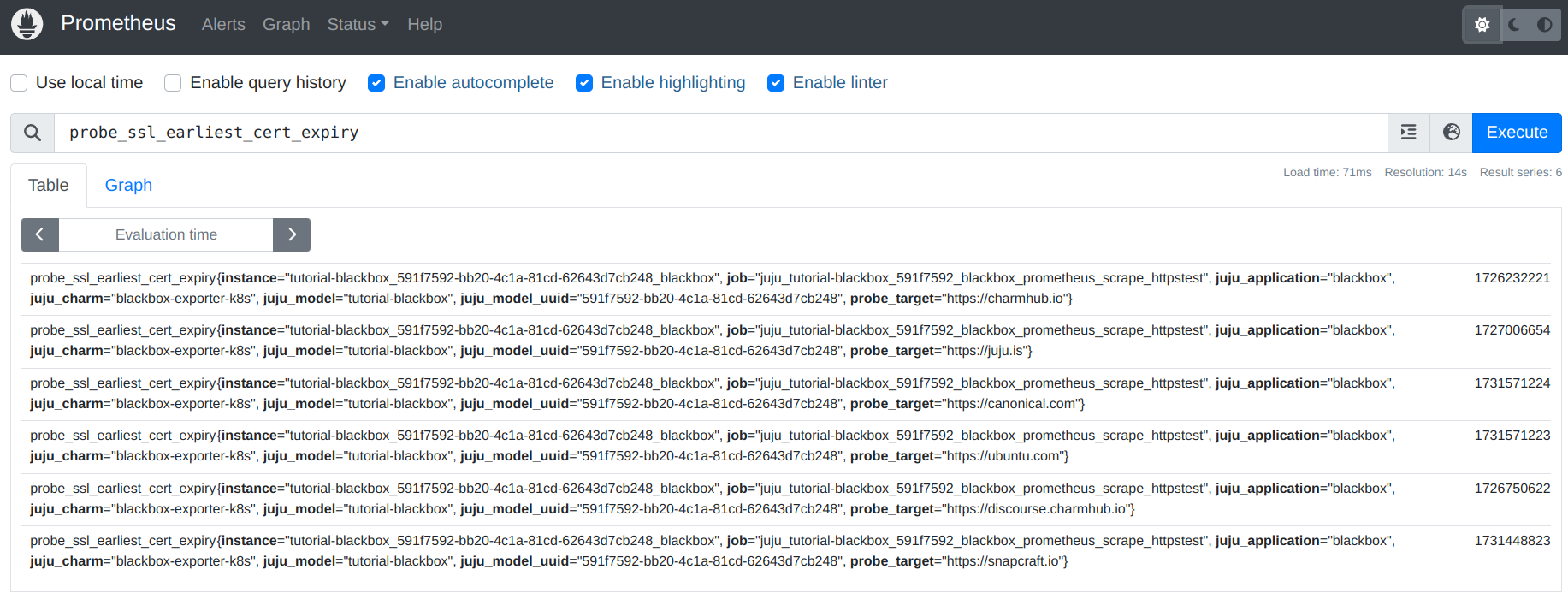

You can now navigate to the Prometheus url (on port 9090) and, after waiting for at least 60 seconds for Prometheus to scrape the exporter for the first time, you’ll be able to type probe_ssl_earliest_cert_expiry and see the data in Prometheus.
But this raw data is not useful on its own: let’s leverage the integrations with Grafana and Alertmanager to get some insights on the certificates we want to observe.

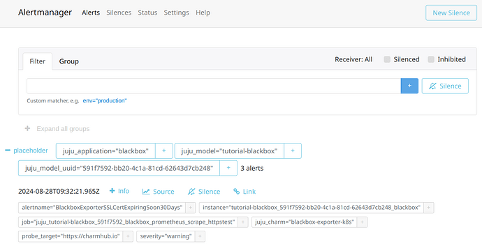

Check the alerts in Alertmanager
Navigate to the Alertmanager UI (on port 9093). You’ll see the alerts that Blackbox Exporter is sending to Prometheus over the metrics-endpoint relation.
You’ll get two types of alerts:
  • a warning alert, when the certificate will expire in less than 30 days;
  • a critical alert, when the certificate will expire in less than 15 days.
If you want to add different alerts, you can use the cos-configuration-k8s charm to send extra alert rules to Prometheus from a Git repository.
To configure Alertmanager to send you notifications, check our documentation.

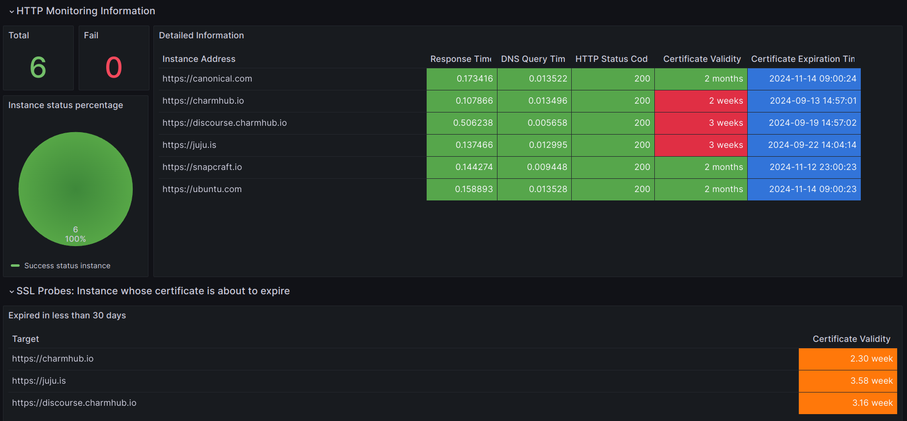

Look at the Grafana dashboard
Navigate to Grafana (on port 3000) to take a look at the dashboard. Login with the default admin account: you can get its password by running the get-admin-password action:
juju run grafana/leader get-admin-password
Use the sidebar to navigate to the dashboards, and open the “Blackbox Exporter” one in the “General” folder. The dashboard has lots of information, but the part related to certificate expiration should look like this:
You can sort the table by Certificate Validity by simply clicking on the header, so you can immediately see which certificates will expire first.
