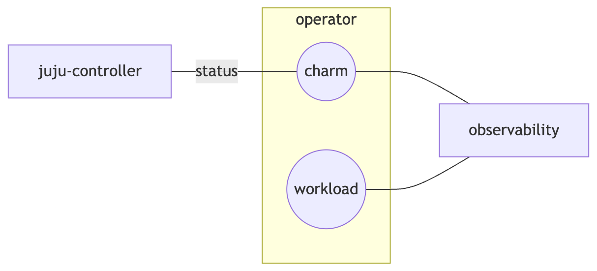

Often, an admin looks at the output of juju status and sees a green active/idle, even though something is definitely wrong - for example, no space left on device.
With separation of concerns in mind, we should ideally use juju status (and juju log) for operator concerns, and standard observability for workload concerns. This separation can be a bit fuzzy when the charm itself is instrumented, since the charm’s own logs and traces may also be forwarded to the same observability backend. That is a good thing - it enables alerts and dependable support. Technically, “everything” can and should end up in your observability backend.

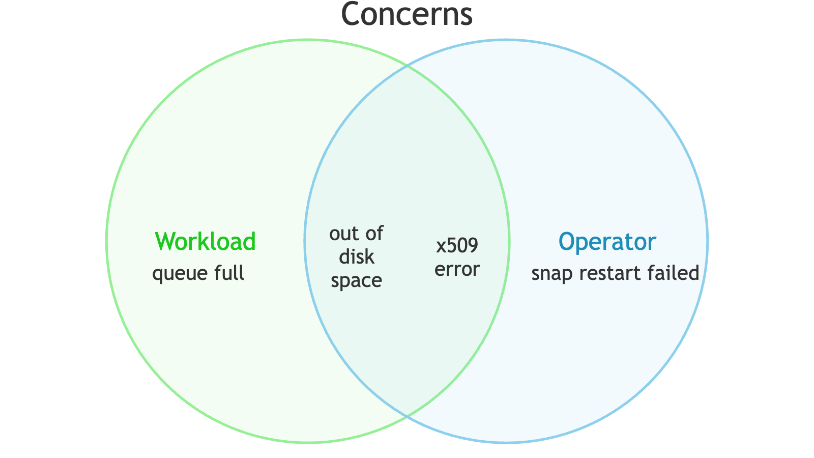

But which situations belong in juju status? Pure operator concerns such as snap management are obvious, but some situations are both a workload and an operator concern, and would benefit from being reflected in juju status in addition to the observability backend.
(Edit a copy of this diagram)
Situation Workload concern Operator concern
no space left on device back-pressure; service outage charm config options that affect disk usage; know-how on safe purging (destructive data loss), but must not be automated - must be triggered by admin
x509 error back-pressure; service outage relation data incomplete, incorrect or outdated; charm depends on root ca certs the oci image didn’t include
In other words, the “concern” is not necessarily “juju status” vs. “observability”, but rather more contextual and fluid - e.g. “handover vs operation”, “admin vs SRE”, “ssh vs gui”, “rapid response vs in-depth investigation”. There is also no exclusivity restriction: we can log and block for the same reason. Looking at juju status is similar to running htop or ps aux | grep ... - it’s familiar, easy and straightforward, and currently some admins rely on it.
