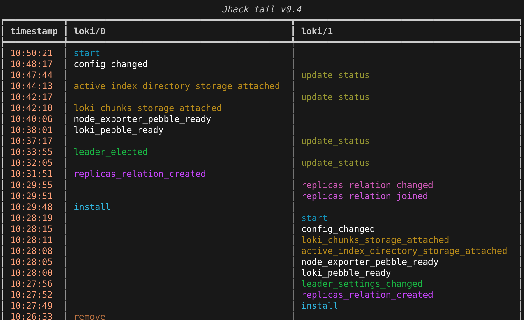

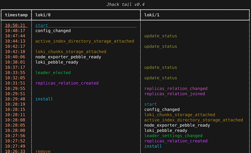

Then, we deployed the charm with 2 units to see how leadership will change. By default, loki/0 unit is the leader unit that will sleep at the end of every event.
After some time:
Although loki/0 unit exceeded the LEASE_RENEWAL_PERIOD, the charm container has not been killed and remained leader for the entire lifecycle of events. You can see the 2-mins delay between each fired event which indicates that neither the leadership has been affected nor the queue of events for the blocking unit.
