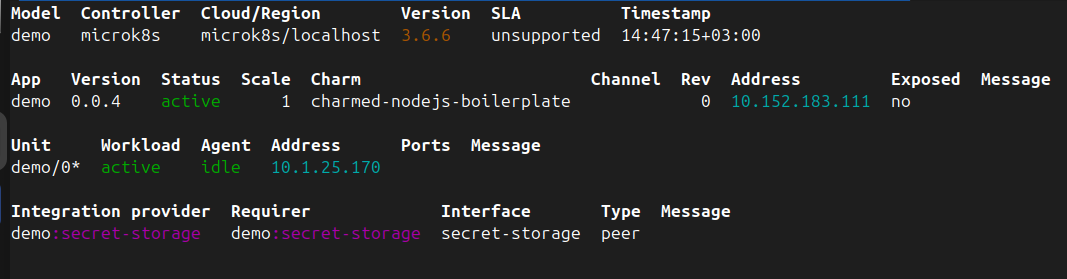

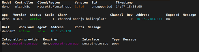

9- Deploy the application locally. Let’s first create a model to deploy our example application.
juju add-model demo
juju deploy ./charmed-nodejs-boilerplate_amd64.charm demo --resource app-image=localhost:32000/charmed-nodejs-boilerplate:0.0.4

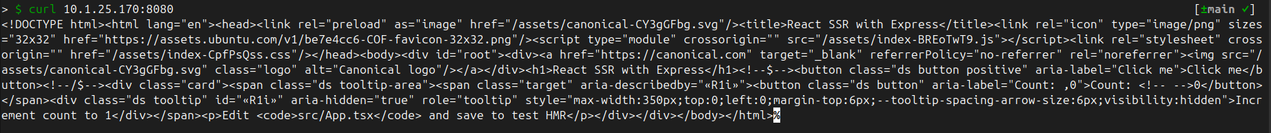

By default the port in the 12 Factor Express application is 8080. We can curl the application to see if it is working:
curl 10.1.25.170:8080
It is working!
