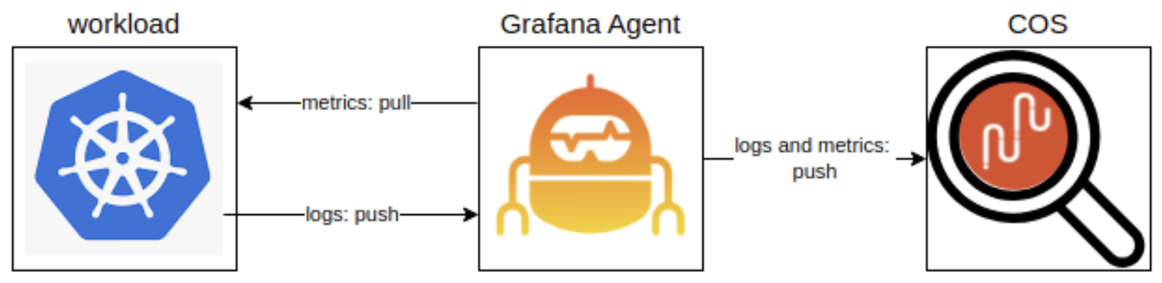

In the recommended deployment scenarios, a telemetry aggregator, such as grafana agent, is used to funnel logs and metrics to COS. In this case, grafana agent takes over the responsibility to push logs as well as metrics into COS: so it’s not required for the COS stack to be able to reach the grafana agent, but the agent must be able to reach the COS stack. The grafana agent needs to be able to reach the charms and workloads generating the telemetry, and the other way around.
The image below describes a typical COS deployment observing both a LXD- and a Kubernetes cloud. In the following sections, you’ll find a brief summary of the use case of each of the components that make up a data path between a telemetry emitter and COS itself.
