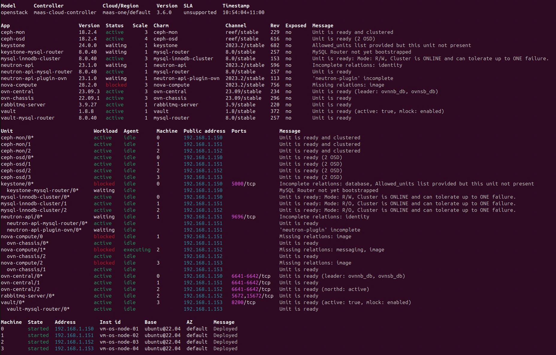

For now, I’ve just completed the RabbitMQ step (as explained here: https://docs.openstack.org/project-deploy-guide/charm-deployment-guide/latest/install-openstack.html) which is a stop-and-check point. When checking, the following status is shown:
As can be seen, I have a I have a “MySQL Router not yet bootstrapped” issue for the keystone-mysql-router app.
