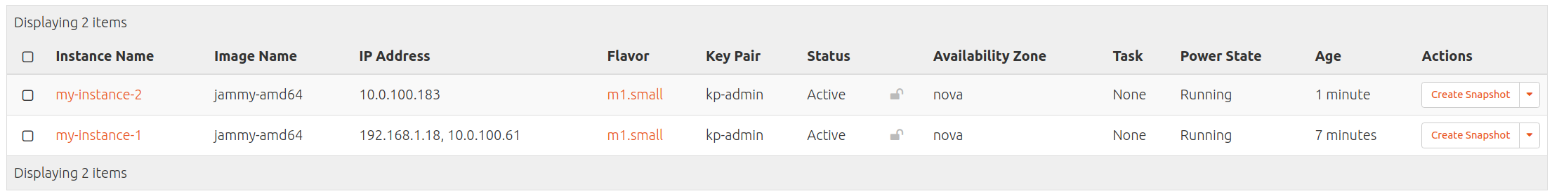

For example in my case, I can ping my-instance-1 with the floating IP 10.0.100.61 but not my-instance-2 with the IP 10.0.100.183:
