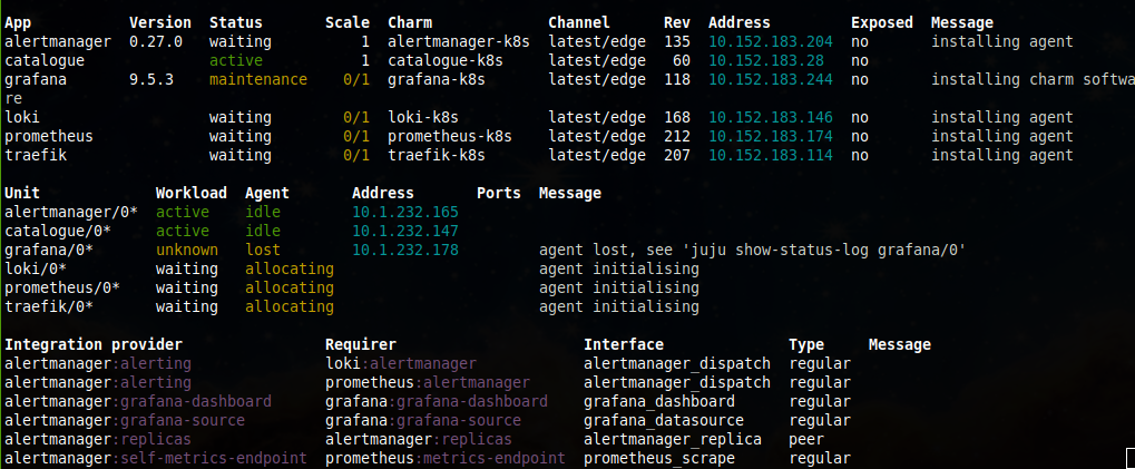

First, you need a model with some applications

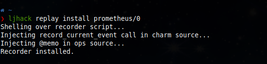

Next, you need to run
jhack replay install myapp/0
For example:
Note the ominous output, which gives a good overview of what’s going on. Jhack is:
  • pushing to the unit a python module
  • rewriting the charm source (charm.py) using obscure ast trickery to insert a call to that module
  • rewriting several ops modules (pebble.py, model.py) also with ast to inject more calls to that module every time the charm interacts with pebble and hook tools

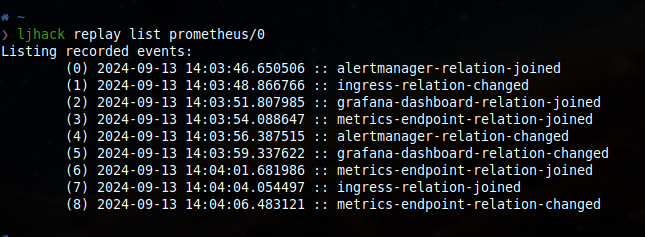

jhack replay list myapp/0
to view a full list of all events that have been recorded. For example:
Note the first column of the output: those IDs are assigned by the recorder itself, and we need to use them when interacting with it further.
