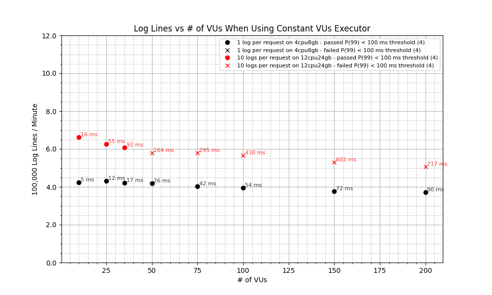

Let’s do an initial experiment to get a feel for K6. We’ll do this initial experiment using the constant VUs executor. With this executor, we can specify the number of VUs and the duration of the test and K6 will attempt to carry out as many requests as possible. This means that K6 will send a request and as soon as that request is completed, it will send another one. See the snippet below:
export const options = {
  scenarios: {
    custom_vu_test: {
      executor: "constant-vus",
      vus: 3,
      duration: "10m",
  thresholds: {
    errors: ["rate<0.01"],
    request_duration: ["p(99)<100"],
  discardResponseBodies: true,
The workload being load tested is a single unit of the Otelcol K8s charm. Requests from K6 will send logs to port 4318 of Otelcol which is the default OTLP port over HTTP. Since this charm is isolated and not related to a log storage backend (such as Loki), logs received by Otelcol will be written to STDOUT using the debug exporter. Let’s start with a 4cpu8gb machine and see where we go from there. The Otelcol charm itself has been constrained to 2cpu4gb, which is reasonable for a collector. The objective here is to get a feel for the maximum number of log lines per minute that Otelcol can ingest while passing the following thresholds:
  1. 99% of responses returned by Otelcol should have status code 200. This means that for the duration of the load test, Otelcol should be generally available and up.

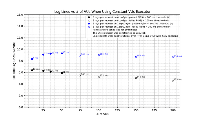

  2. The 99th percentile of the requests should take less than 100 milliseconds to be complete. On that note, let’s also confirm whether continuing the tests on a 4cpu8gb machine is a good idea. We should also settle on the number of logs we want each request to contain. We’ll run the test for 10 minutes. The result looks as below:
Not a bad start! We have alternated between different numbers of VUs and logs per request and seen that as the number of VUs increases, the 99th percentile of responses becomes slower and slower and at around 75 VUs, we start to go over the 100 ms threshold. More importantly, Otelcol was able to take in a maximum of 660,000 log lines per minute in the best case scenario, which is a significantly high number! There are, however, some important takeaways here:

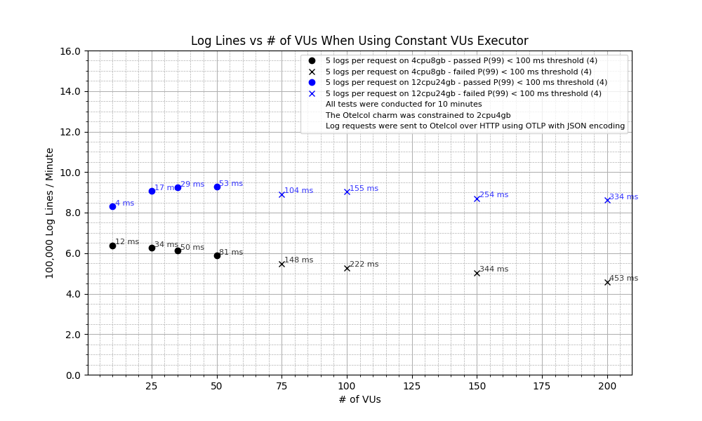

  1. Going forward, let’s take the middle ground between 1 and 10 logs per request. We’ll stick to 5 logs per request from now on.
  2. Throughout the 10 minute test duration, all four CPU cores were at or above 95% utility. Since both K6 and Otelcol were on the same machine, this suggests that either of them could have been starved of resources which may have negatively impacted their performance. For future tests, we’ll use a host of 12cpu24gb. We can keep the collector constrained to 2cpu4gb.
Let’s put our improvements to a quick test. We’ll try again with 5 logs per request on two different machines: one of 4cpu8gb and one of 12cpu24gb. The results speak for themselves:
We have now managed Otelcol to ingest close to 950,000 logs per minute with an average latency of 53 ms.

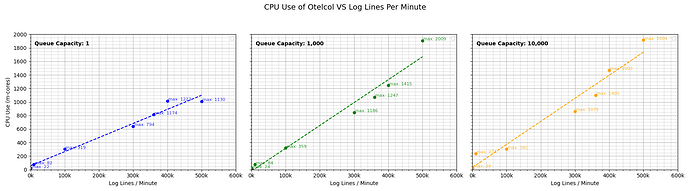

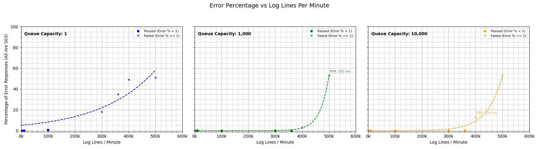

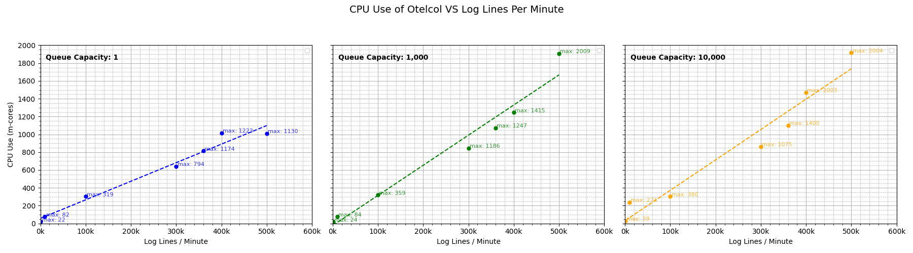

Throughout the load test, we will monitor the CPU and memory use of the Otelcol pod.
Similarly, we’ll also look at how the error rate changes for different log lines per minute.
As the graphs tell us, the queue of 1,000 is working as expected and performance within the reasonable range of 100K to 200K logs per minute is generally acceptable, both in terms of resource usage and up-time. We have ascertained that a queue size of 1,000 works like a charm (pun intended)!

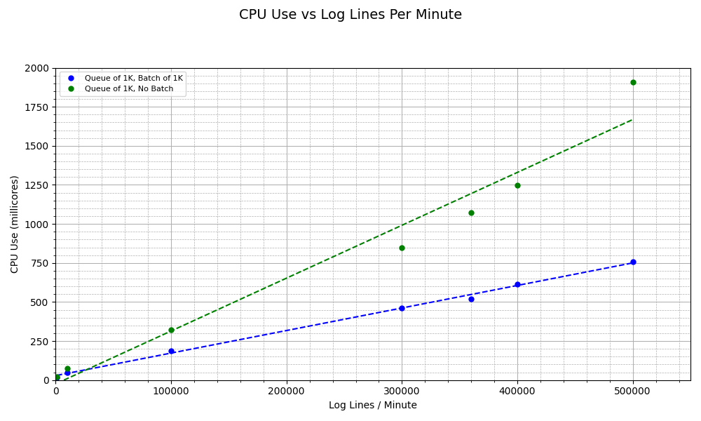

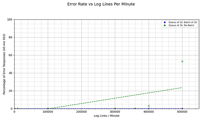

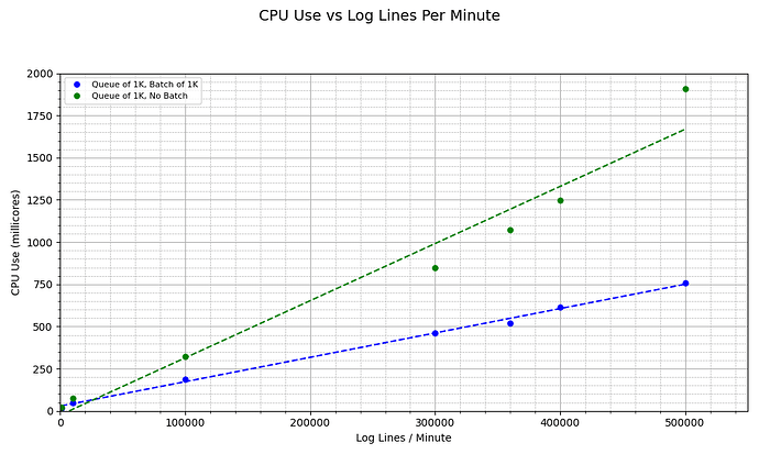

We can now repeat our load test using this batch processor (with a sending queue of 1,000) and compare it to the scenario where we only had a sending queue of 1,000.
The graph below shows the CPU use in the two scenarios across different levels of logs per minute.

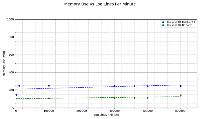

Interesting plot! Since we are using batches, the OpenTelemetry Collector sends data in larger, grouped chunks rather than individual items. This significantly reduces the number of outgoing requests made to the backend, which in turn lowers the overhead associated with network I/O, connection handling, and serialization. But wait: since we are keeping data in batches and then sending them to queue, this means we are holding more telemetry inside Otelcol at all times. How does the memory use change?

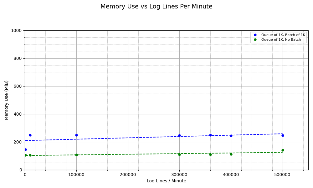

Aha! The overhead of the batch processor goes to memory. Across all values of log lines per minute, we consume twice the level of memory when batching compared to when we aren’t. This highlights a trade-off:
The batch processor comes with less CPU but more memory overhead.

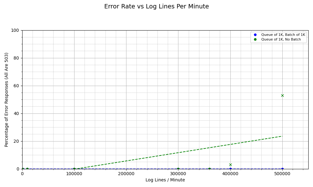

Most importantly, when batching, we get no errors from Otelcol. This can be due to the fact that since batching leads to less resource usage, Otelcol has more processing available to respond to the relatively high level of requests coming in from K6. Thus, we avoid a denial-of-service scenario by reducing required processing power through batching.

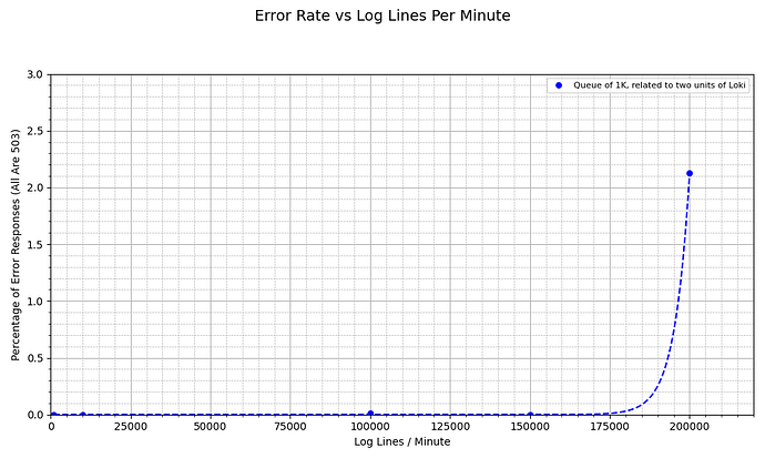

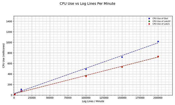

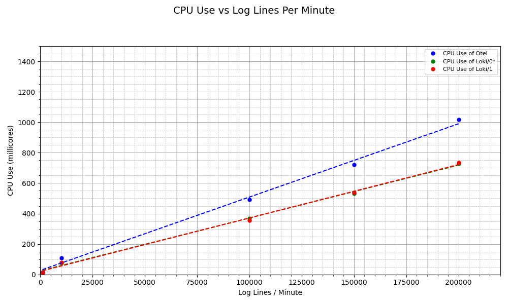

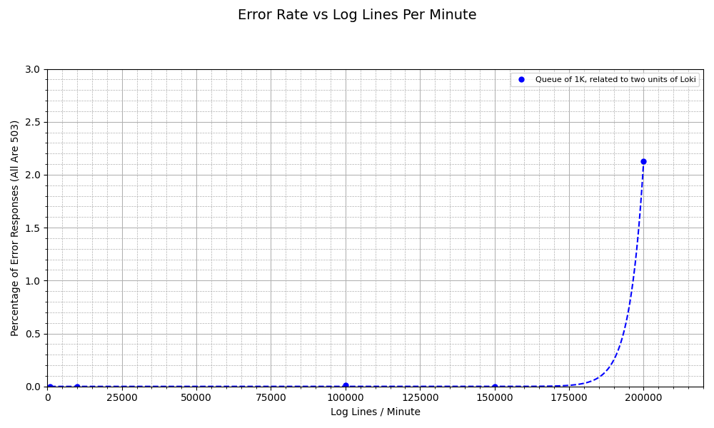

Now that we have (somewhat) mastered K6, confirmed the benefits of the queue and batch processor, and managed to get relatively high levels of log through Opentelemetry Collector, let’s now try and see how much load Opentelemetry Collector can handle when it’s related to two units of Loki over TLS. A quick note that Loki has a constraint of 4cpu8gb. Once again, we look at CPU and memory use across different pods.
The two Loki pods are very similar in CPU use. The graph seems to look as expected and show that there is a linear relationship between CPU use and the level of logs ingested. The error rate is the most encouraging, particularly because it remains close to zero while we are in the normal 100K - 200K logs per minute range and even as we approach higher values, it still remains relatively low.
