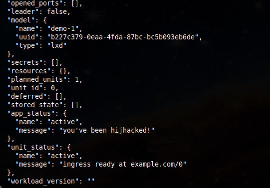

Suppose you have a model called demo-1 containing a tester app. If you type jhack scenario snapshot tester/0 --format json, without arguments, you will obtain a printout containing the whole charm state: its relations (and their data), its networks, its stored state, its deferred events, containers, and so on.

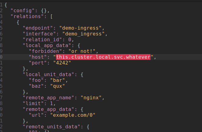

To edit the relation data for some endpoint of this charm (or multiple at once, why not?), we pipe this out to a file and edit it in there:
jhack scenario snapshot tester/0 --format json --include r > ./tester-state.json
The --include r argument means we only want to collect relation state. This significantly speeds up execution.
We change the ‘host’ value of the demo-ingress relation’s local app databag and then run:
jhack scenario state-apply tester/0 ./tester-state.json

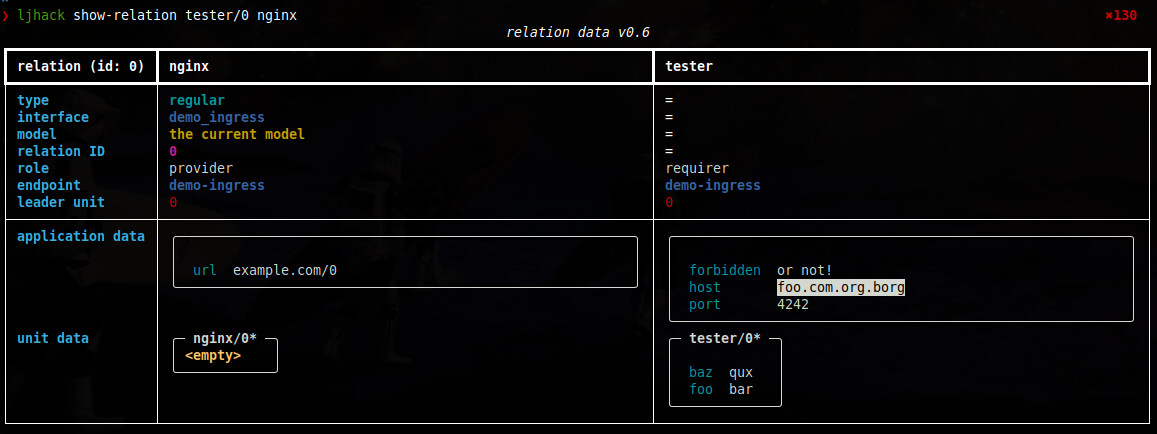

And the relation data gets updated!

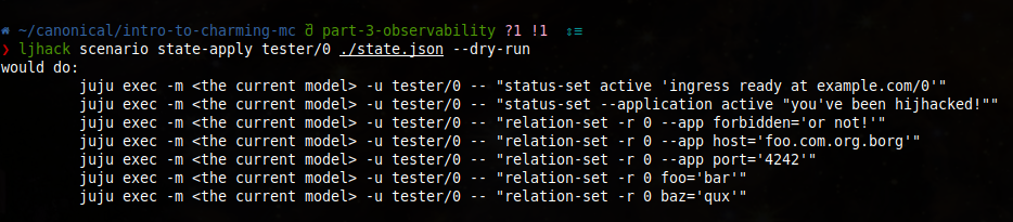

If you want to see the commands that jhack state-apply is emitting on your behalf to do this magic, add a --dry-run flag and see:
