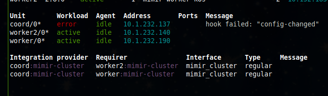

Here’s the status for my setup from Juju, to help illustrate:
juju status
livepatch kubernetes kubernetes 3.1.6 unsupported 08:20:51-05:00
App Version Status Scale Charm Channel Rev Address Exposed Message
ingress 25.3.0 active 1 nginx-ingress-integrator latest/stable 81 10.111.165.16 no
livepatch waiting 1 canonical-livepatch-server-k8s latest/stable 21 10.111.85.31 no waiting for units to settle down
postgresql 14.9 waiting 1 postgresql-k8s 14/candidate 158 10.109.182.135 no waiting for units to settle down
Unit Workload Agent Address Ports Message
ingress/0 active idle 10.36.0.17
livepatch/0 blocked idle 10.47.0.5 waiting for pg relation.
postgresql/0 waiting idle 10.36.0.15 awaiting for cluster to start
