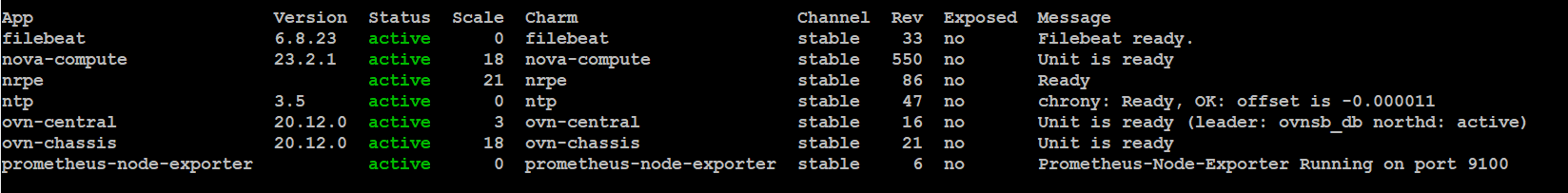

What version of OVN are you currently running? Check this with:
juju status ovn-central ovn-chassis
This is a known upstream OVN issue; version 20.12
(what you’re running) does not have adequate upgrade support for the non-downtime of the OVN data plane. However, there is upstream documentation (fail-safe upgrade) that can work around this. I will update the Charmed OpenStack documentation accordingly.
