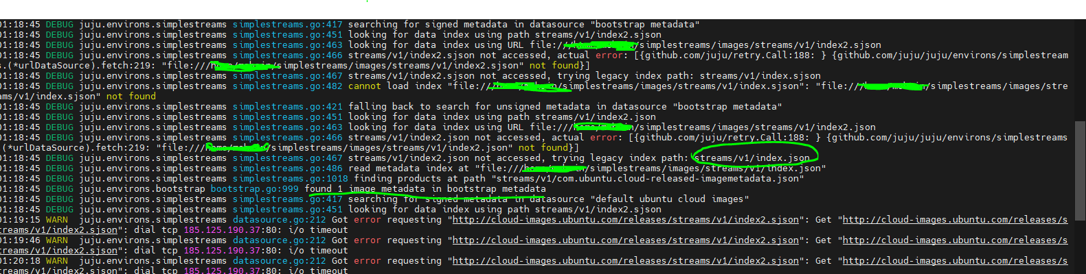

Logs:
I am aware that lot of people faced this problem in the past and it could be related to a network issue in our env. If anybody can point me to right direction would be helpful.
Hi
As you say, this looks like a network issue in your env. The controller VM is unable to reach simple streams.
However, since you’re providing a metadata source, you shouldn’t need this. Once this is resolved, you may find you run into another problem. It is possible to bootstrap juju in an air-gapped environment, but takes a bit of work.

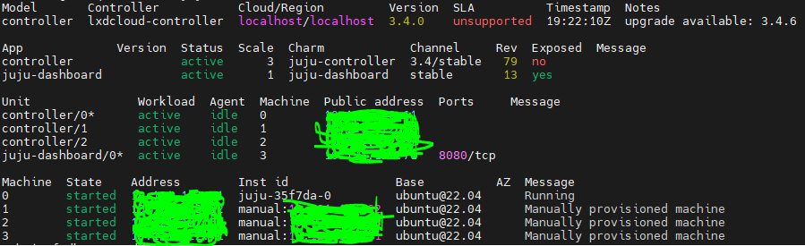

we already have it deployed on LXD Baremetal cluster and everything works we are in the process of testing on openstack and deploying on our production use cases globally on openstack platform juju orchestrator with k8s backed by openstack private cloud. Hope we make it work.

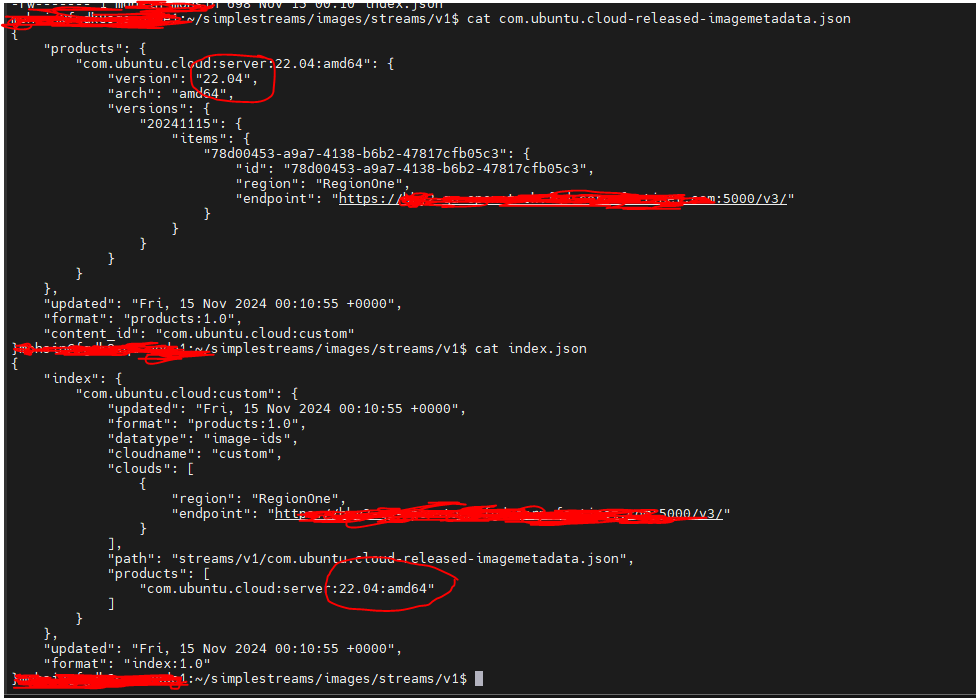

Could you check the contents of your simplestreams metadata? And verify the bases are correct?
Thanks for your response. Checked below is the info attached.
