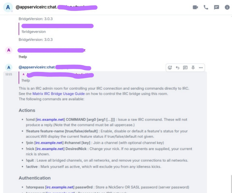

Interact with the bridge
Access Synapse via Element with the admin user created previously.
To interact with the Bridge, you can invite the user ircappservice to a room or sent a message.
Send a message to the user ircappservice. If a warning shows up, ignore and proceed.
The Bridge will show a help menu with all the options available. Try the following to guarantee that the bridge is working.
!bridgeversion
To check all available options, send the following command:
!help
Screenshot example:
Join a IRC channel
You can send a message to the user ircappservice like !join #python and this will be interpreted as a command to join the python channel.
After this, you can join the room python that corresponds to the IRC python channel.
