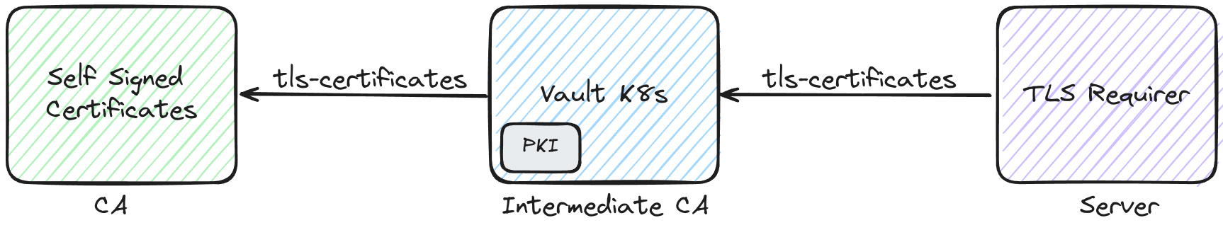

In this how-to guide, we will configure Vault to act as an intermediate Certificate Authority (CA) using Vault’s PKI secrets engine. Here self-signed-certificates will be the parent CA and tls-certificates-requirer will be the charm requesting a certificate to Vault.
The certificates issued by Vault will have a validity period that is half of its intermediate CA’s, which is determined by the root provider’s configuration, in this case, the self-signed certificates.
