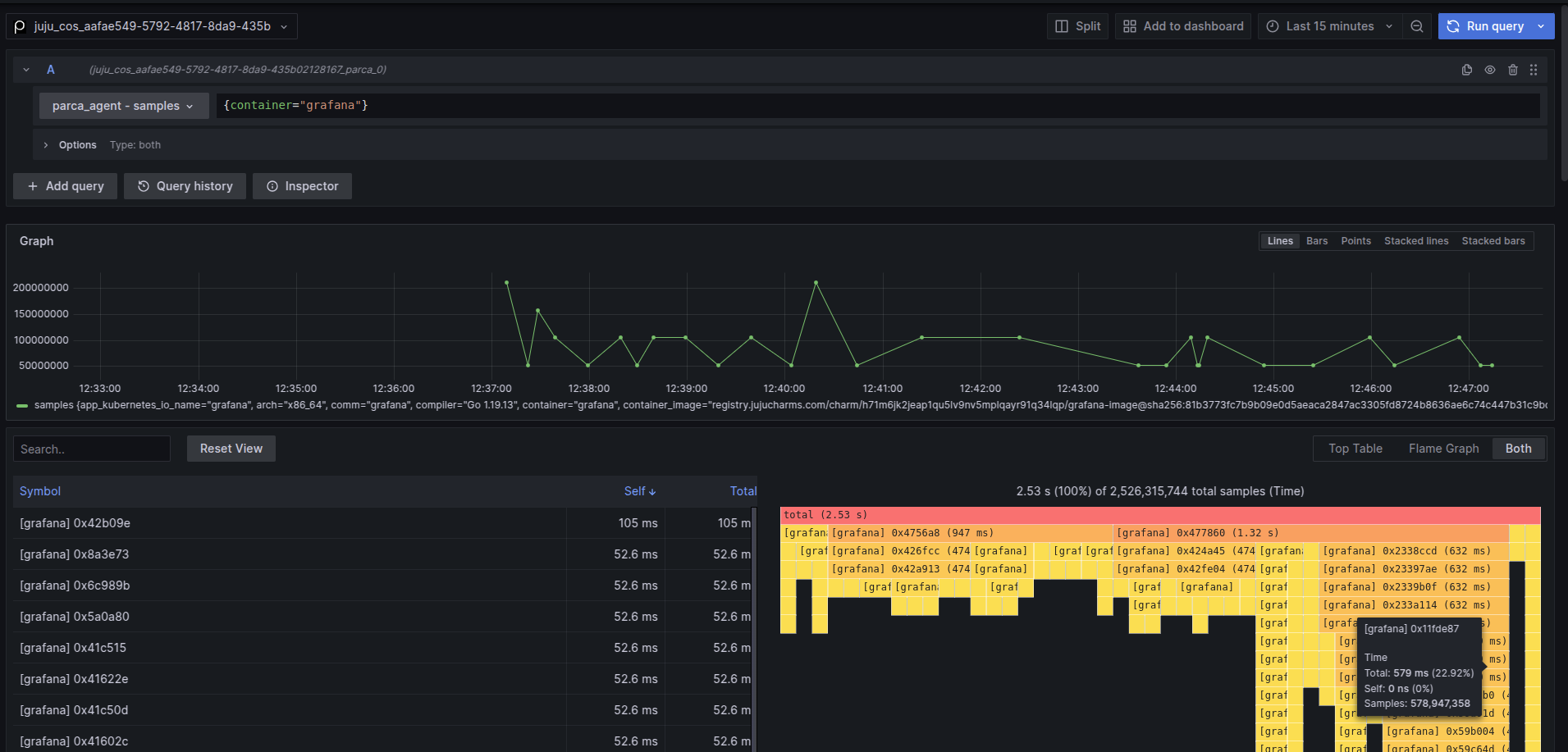

Now open grafana in a browser (in the cos model, run juju run grafana/leader get-admin-password
In Grafana’s Explore view, select the Parca datasource and verify there’s parca_agent
in the profiles tab. If you deployed COS on the same Kubernetes cluster that is being profiled, you should be able to see profiles from each of the applications that parca can natively instrument:

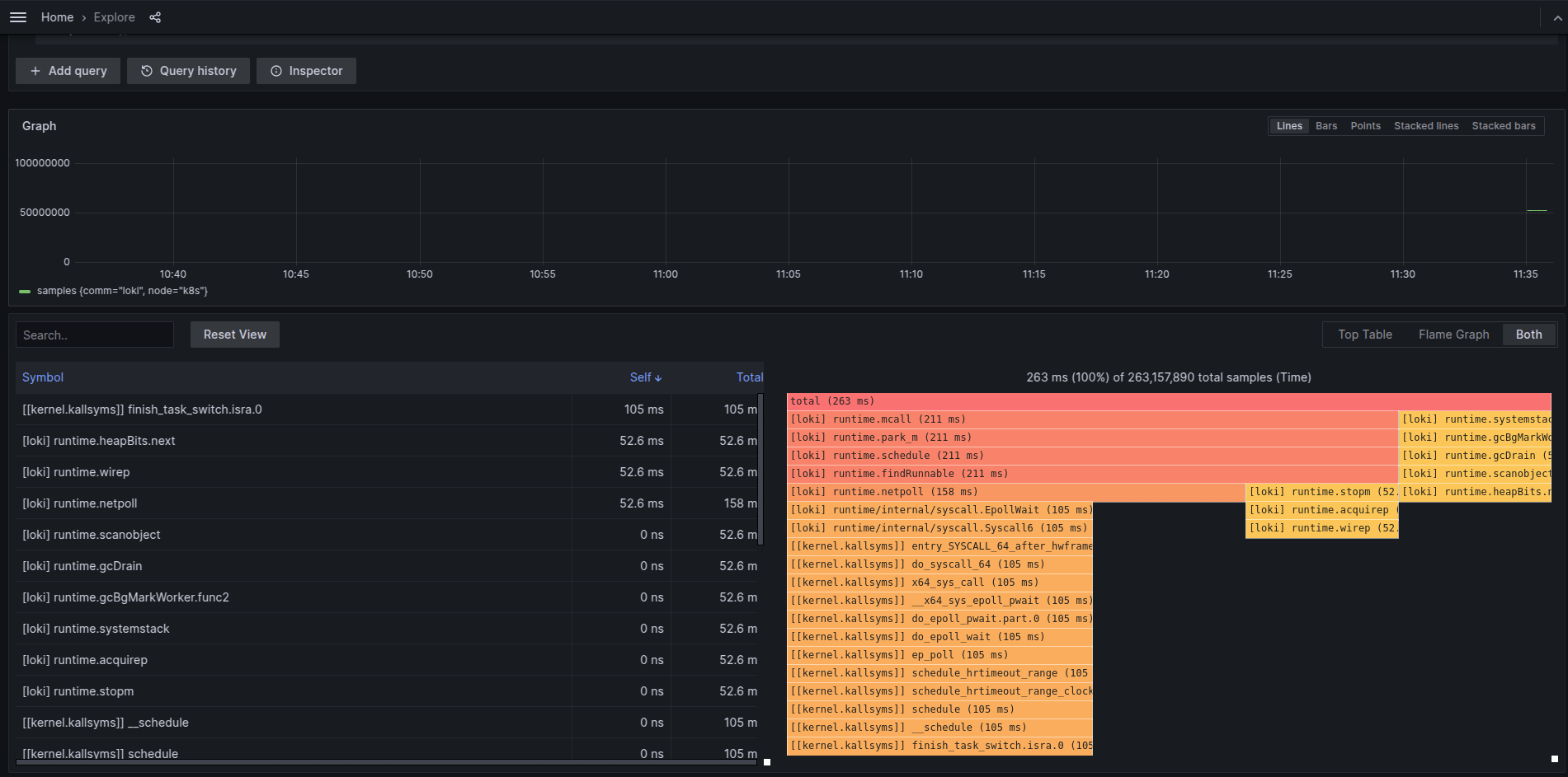

Observe in Grafana that the profiles from parca-agent
are available in the Parca datasource:
