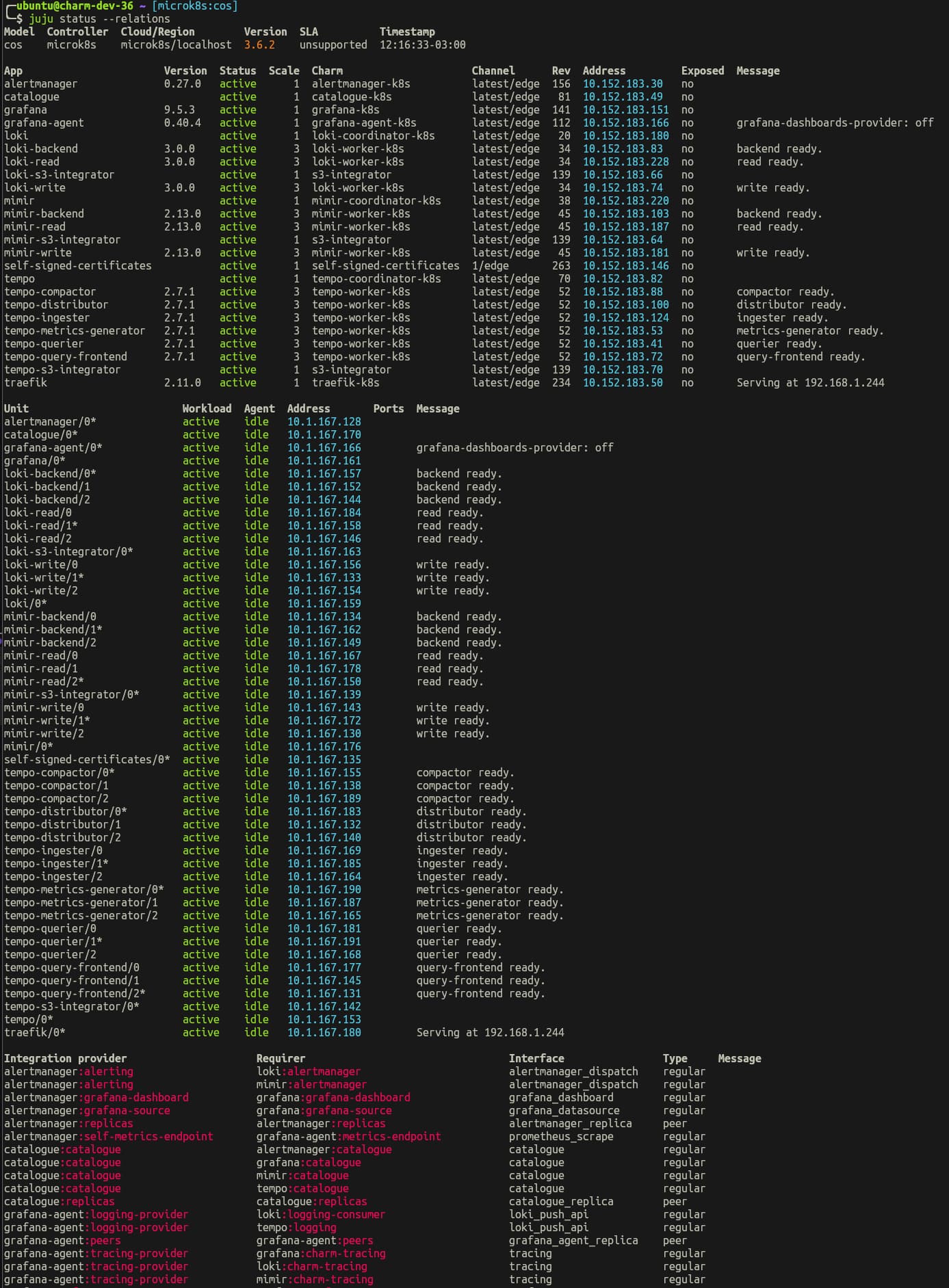

Then, use terraform to deploy the module, using 3 units per worker:
terraform init
terraform apply -var='s3_password=bar' -var='s3_user=foo' -var='s3_endpoint=http://192.168.1.145' \
-var='loki_bucket=loki' -var='model_name=cos' -var='mimir_bucket=mimir' -var='tempo_bucket=tempo' \
-var='loki_backend_units=3' -var='loki_read_units=3' -var='loki_write_units=3' \
-var='mimir_backend_units=3' -var='mimir_read_units=3' -var='mimir_write_units=3' \
-var='tempo_compactor_units=3' -var='tempo_distributor_units=3' -var='tempo_ingester_units=3' \
-var='tempo_metrics_generator_units=3' -var='tempo_querier_units=3' -var='tempo_query_frontend_units=3'
Some minutes after running these two commands, we have a distributed COS deployment!
