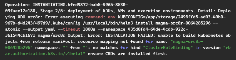

Initially I followed KNF Onboarding ( Magma-OSM ). But after following out the guide, Instantiating the fb_magma_knf , it is throwing the following error :
I got to kow this error is due to “The rbac.authorization.k8s.io/v1beta1 API version of ClusterRole, ClusterRoleBinding, Role, and RoleBinding is no longer served as of v1.22.”
And the solution is to find a new helm-chart for this NS. which i cant find anywhere.
So I thought solving the juju error might be an easier task compared to this issue, Please let me know if there any other working resources for magma on-boarding through OSM.
