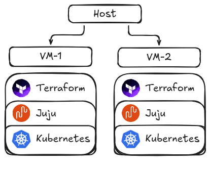

The purpose of this setup is to automate the provisioning of a fresh Ubuntu device. To do this, I use 3 main tools: Multipass (VMs), Chezmoi ($Home dir config mgmt), Just (task runner).
Multipass
I run everything in Ubuntu VMs (for security) and mount my host’s ~/work directory into these VMs, for syncing my Git repos and setup recipes between them.

Great, now you have your $HOME dir state backed up, a shell function, and the necessary tools installed! The new goal is to set up the VM(s) with the following commands:
  1. charm-dev-new foo
    • Launches a multipass VM named charm-dev-foo
    • Cloud-init manages the initial config of a VM, e.g. git & shell
    • Mounts the ~/work dir into the VM
    • Copies the host’s (fine-grained) git auth/signing private key into the VM
      • Ensure that this is authorized in GitHub SSH settings
    • Runs the post-init and canonical justfile recipes to finish setting up the host
