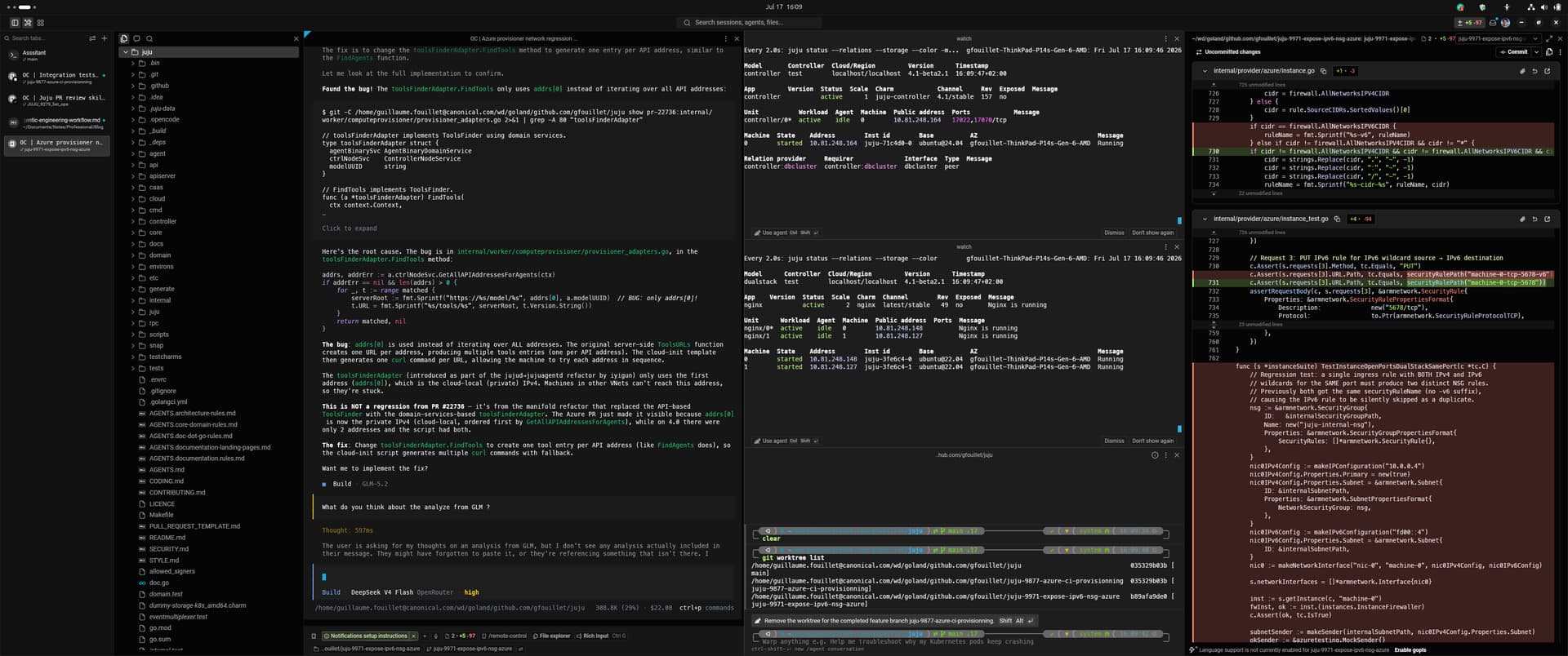

I run three tools inside Warp, which I treat as my agent engineering IDE: multi-pane layout for running agents side-by-side with shells, current diffs, parallel worktree sessions in tabs, and a project explorer.
Opencode is my interactive dev workhorse. It auto-discovers all my OpenRouter models without per-model configuration, and its session database tracks input and output tokens separately. Critical for cost analysis. I use it for the explore → plan → implement cycle where I’m in the loop giving feedback at each step.
Hermes handles explorative tasks where I’m not in the driving seat. It builds persistent memory as it works: each debugging or QA session feeds a knowledge base that makes the next one faster. It also runs cron prompts, so daily session synthesis and weekly retrospectives happen without me thinking about it. Honestly, half the time I forget it’s running, and then I check the logs and find it caught something I missed. I’m still not sure if that’s a feature or a problem.
A warpified zsh shell for manual QA and quick checks. Sometimes you just want to type.

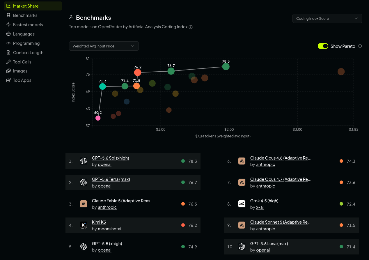

I’ve dropped Claude Sonnet 4.6 and Haiku 4.6. They weren’t worth the cost. I keep an eye on openrouter.ai/rankings with “Pareto” enabled. Recently noticed Kimi K3 took over in cheap models. Might evaluate it to replace GLM for design or Opus for critique.

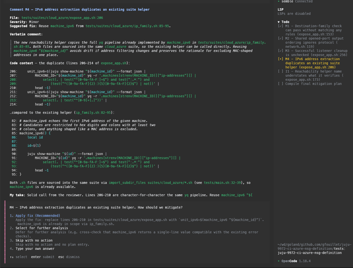

Handle review comment
commands/check-review.md
description: Look at a review — select a list of tasks to handle a review
agent: review-checker
subtask: false
Prepare mitigation for each comment in the review: $ARGUMENTS
agents/review-checker.md
description: Prompt the user about review comment to decide what to do
mode: subagent
model: openrouter/minimax/minimax-m3
permission:
  read: allow
  bash: allow
  question: allow
  edit: deny
  write: deny
For each review comments:
Gather some contextual information and display it to the user:
- code around the comment (if the comment is linked to a source code), at least 10 lines around, if possible back to the method signature). You can add annotation in the displayed code to highlight the relevant part. Help me to understand to comment without burning my cognitive load.
- any metadata (severity, suggested fix)
- the verbatim comment
- your though about the comment, no more than 5 lines.
Then prompt the user with ask_user tool if available, with several options. You can recommend one:
- Apply (if there is a quick fix in the comment)
- Select for further analysis
- Skip with comment
- Skip without comment
Then move to the next comment.
Once every comment handled, gather all those decision in a plan than will be executed later.
