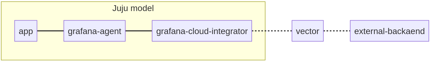

The grafana-cloud-integrator charm can be configured to forward telemetry to not only Grafana cloud, but also to any Loki- (or Prometheus-) compatible endpoint. This is generally useful when running the stack on-premise isn’t desired, or when an additional off-premise storage is used for redundancy.
Vector is a lightweight ultra-fast tool by the Datadog team written in Rust. It’s excellent for being able to build declarative observability pipelines on the fly. In this example, we’ll use it to send our Loki logs to Elasticsearch.
Using the grafana-cloud-integrator charm, we can have grafana-agent send logs to vector, which transforms it to elastic-compatible non-protobuf log lines with a simple setup!

Once that is set up, you’ll simply need to deploy grafana-cloud-integrator, configure the aforementioned loki endpoint in the charm, and relate it to grafana-agent:
juju deploy grafana-cloud-integrator cloud
juju config cloud loki-url=http://some.domain.name:8080
juju relate grafana-agent cloud
The logs will then start to seamlessly appear in your ElasticSearch!
