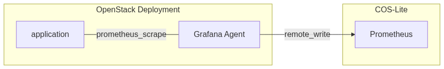

Deployment example
Let’s imagine a Grafana Agent
charm scrapes an application, and forward their logs to a Prometheus
instances in another model.
Signs that something is wrong
In such a deployment, we expect OpenStack metrics to be sent regularly to Prometheus
through Grafana Agent
, but that doesn’t happen.
