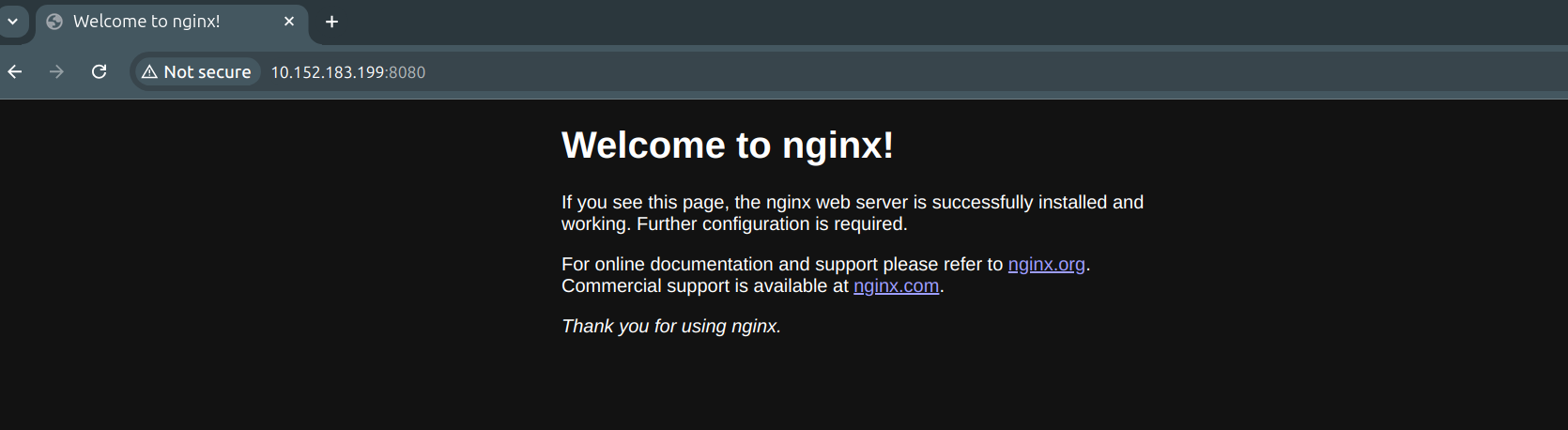

Using your browser, navigate to the application address on port 8080 using the HTTP scheme. Here this would be http://10.152.183.199:8080.
You should see the following page:
We now know that have a working Nginx charm.

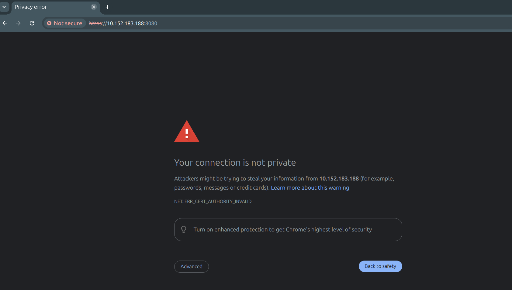

Using your browser, navigate to the application address on port 8080 using the HTTPS scheme. Here this would be https://10.152.183.188:8080.
You should see the following page telling you that the HTTPs certificate is not valid:
Don’t worry, this message is expected since the certificate we received is self-signed.

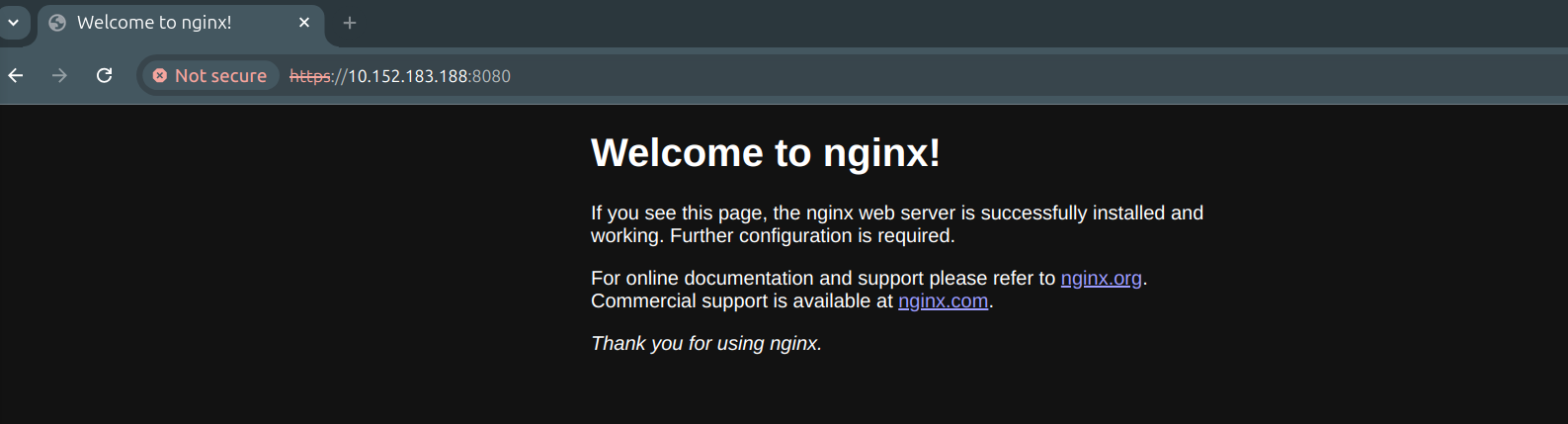

Click on Advanced → Proceed and you should now see the same Nginx page as in step 1.

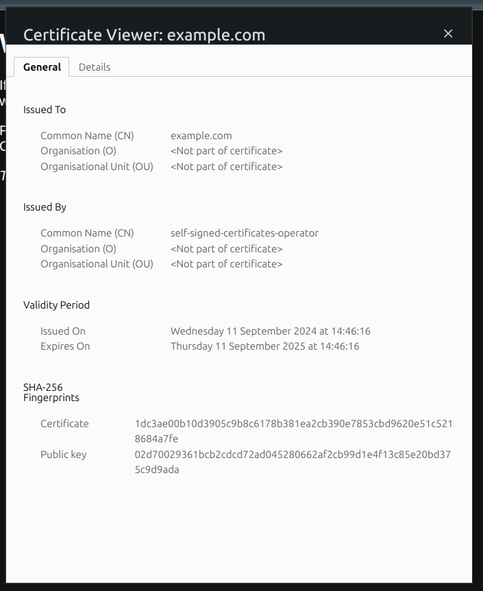

You can inspect the certificate and notice that you received a certificate for example.com.
