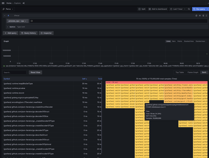

See the profiles
Navigate to Grafana → Explore tab. Choose Parca as a data source and process_cpu -> cpu in the configuration, then click on “Run query”. You should see the profiling CPU data:
Congratulations, you added a profiling integration to a charm!
