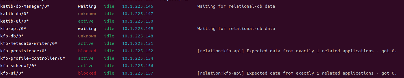

I just followed the tutorial.
All pods work normally, but the following error occurs.
Hey @kkhe56, looks like something is going on with the MySQL databases.
With a quick look the root problems seem to be katib-db and kfp-db, which are using the mysql-k8s charms. The other charms then are blocked because kfp-api is waiting for the database.
We’ll need to further dig into your environment to understand why the DB charms are in “unknown” state. Could you follow up with an issue in https://github.com/canonical/bundle-kubeflow where the team can follow up and ask for more technical details?
