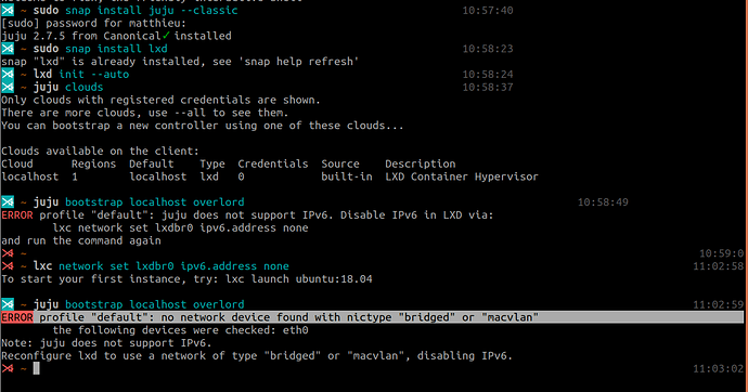

A fresh install of Juju on Ubuntu 18.04 doesn’t work.
I end up with this error after a first juju boostrap attempt:
profile "default": juju does not support IPv6
Then with this error after having disable IPv6:
profile "default": no network device found with nictype "bridged" or "macvlan".
Steps to reproduce in screen capture below:
I have found this PR which seems to fixed this issue (merged 2 days ago). However I don’t know how to use the latest “correct” version of Juju in order to run juju boostrap successfully.
Any comment and/or help about this situation would be much appreciated.

Well done on your perseverance here. Juju’s IPv6 support is in-progress. Until then, disable it in LXD:
lxc network set lxdbr0 ipv6.address none
