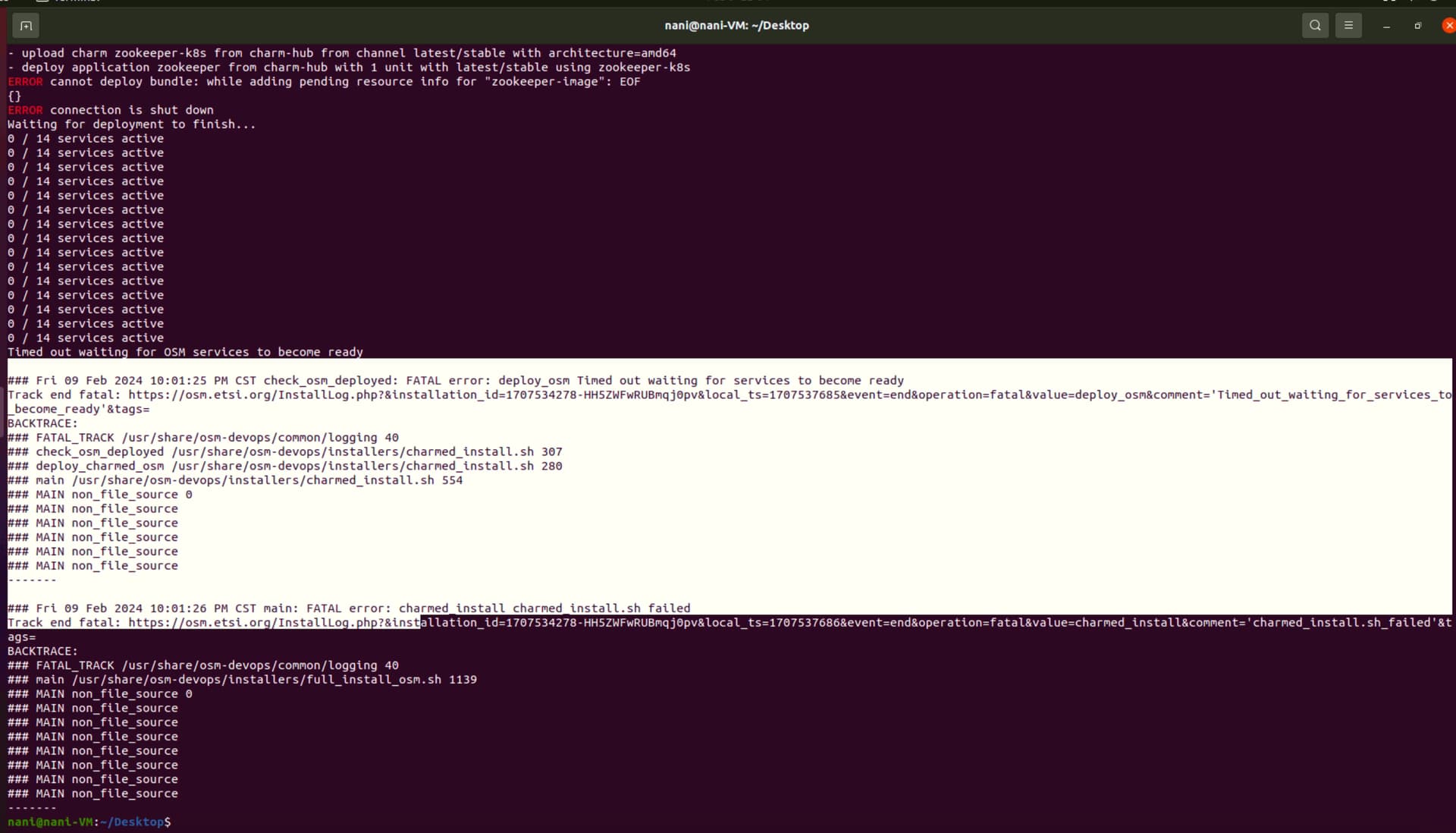

Hey, I want to follow this tutorial, but after entering command ā€œ./install_osm.sh --charmedā€ the installation gets stuck on ā€œcreating k8s resources for controller ā€œcontroller-osm-vcaā€ā€ and then exits with error that no controller is registered. I have clean install of Ubuntu 20.04 LTE, 12 CPU, 16GB RAM and 90 GB of HDD. How can I resolve this problem? Thanks
Hi,
Have you got an answer or you reinstalled your OSM?
Nicolas

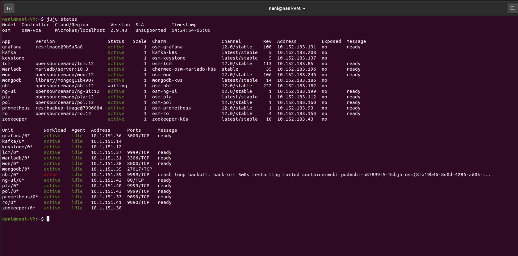

Hi, I am trying to install open source mano on ubuntu 20.04 with the configuration mentioned above, This is the screenshot
@venkatmanavarthi Did you manage to solve the NBI issue you faced? I can see it’s an authentication issue as per below logs from nbi pod but don’t know details about authentication workflow to Keystone
cherrypy.process.wspbus.ChannelFailures: AuthException('Error during user role listing using Keystone: The request you have made requires authentication. (HTTP 401) (Request-ID: req-e00adb14-96cd-4c17-976a-485ea5c5a3e3)')
