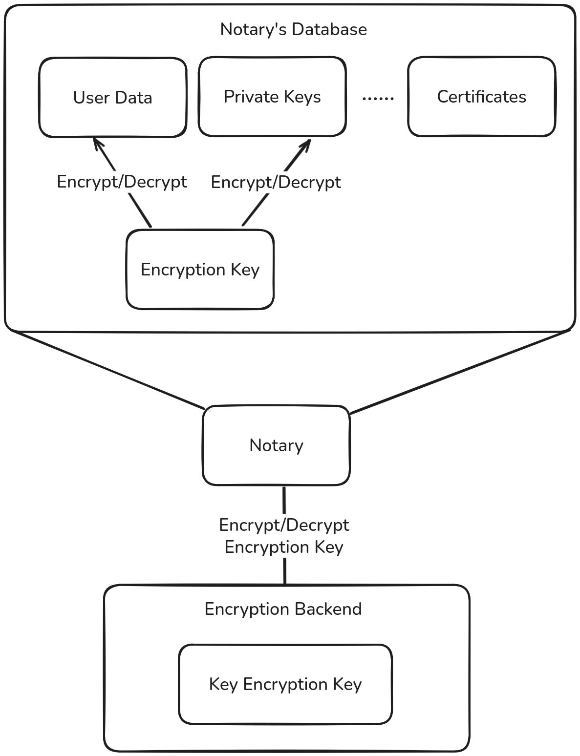

We chose to combine the benefits of both approaches. We store the data encryption key in the database, but encrypted using a second key: the Key Encryption Key (KEK). Management of the KEK is offloaded to an external encryption backend.
We implemented two encryption backends: HashiCorp Vault and Hardware Security Modules (HSMs). On startup, Notary checks for its data encryption key. If it exists in the database, it uses the encryption backend to decrypt it. Otherwise, it generates a new key and uses the backend to encrypt it. Rotating the root encryption key (the KEK) then only requires re-encrypting Notary’s encryption key.
This design ensures the encryption backend is only needed at startup. The root key lives outside the database, and rotation becomes straightforward.
