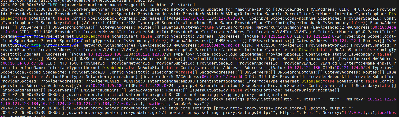

I could see the space name and Space ID is empty in machines logs. below are the details.
ok, so according to this logs, your machines addresses are on the subnet 10.121.122.0/24 which is in the space beta. Since you have not yet configured juju to take beta as the ha-space, you won’t be able to enable-ha with these two machines.
