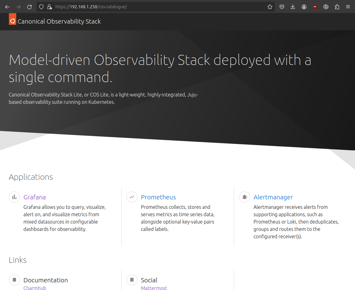

Regarding the bridged network you can launch a Multipass VM this way (note the --network enp1s0)
multipass launch --cloud-init charm-dev-juju-3.4.yaml \
--timeout 1200 \
--name charm-dev-34 \
--memory 8G \
--cpus 4 \
--disk 60G \
--mount /home/jose/trabajos/canonical/repos:/home/ubuntu/repos \
--network enp1s0
Once the machine is working you can check that has an IP provided by the DHCP:
╭─ubuntu@charm-dev-34 ~ [microk8s:cos]
╰─$ ip r | grep default | grep 192
default via 192.168.1.1 dev enp6s0 proto dhcp src 192.168.1.178 metric 200
Now you need to enable metallb in the VM so Traefik may get an external IP:
sudo microk8s enable metallb 192.168.1.250-192.168.1.255
Note that we are assigning metallb a range between *.250 to *.255. Make sure that your DHCP will NOT use those IPs.
Now you can access your charm’s UIs using a LAN IP:
