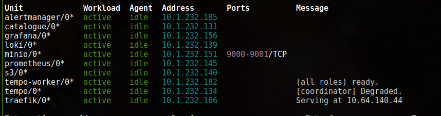

At this point your juju status
should look like this:
Coordinator is reporting ‘degraded’ because not all roles are assigned in the recommended number (see this open bug for progress on making the status message more informative).
