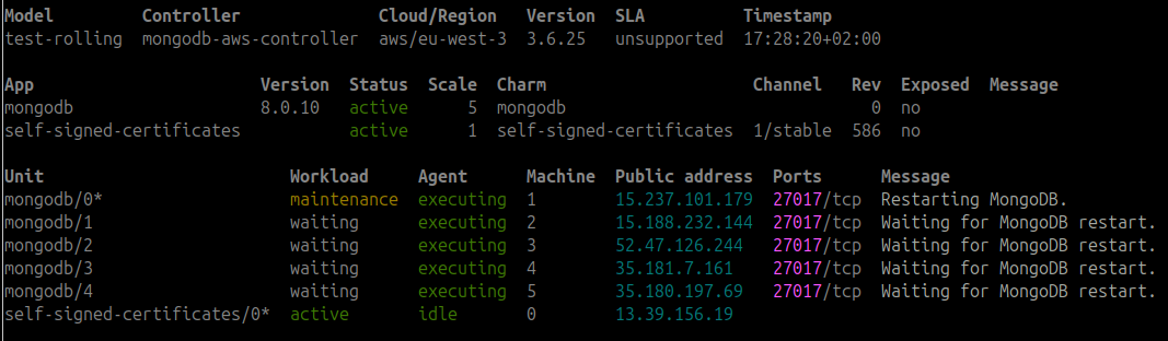

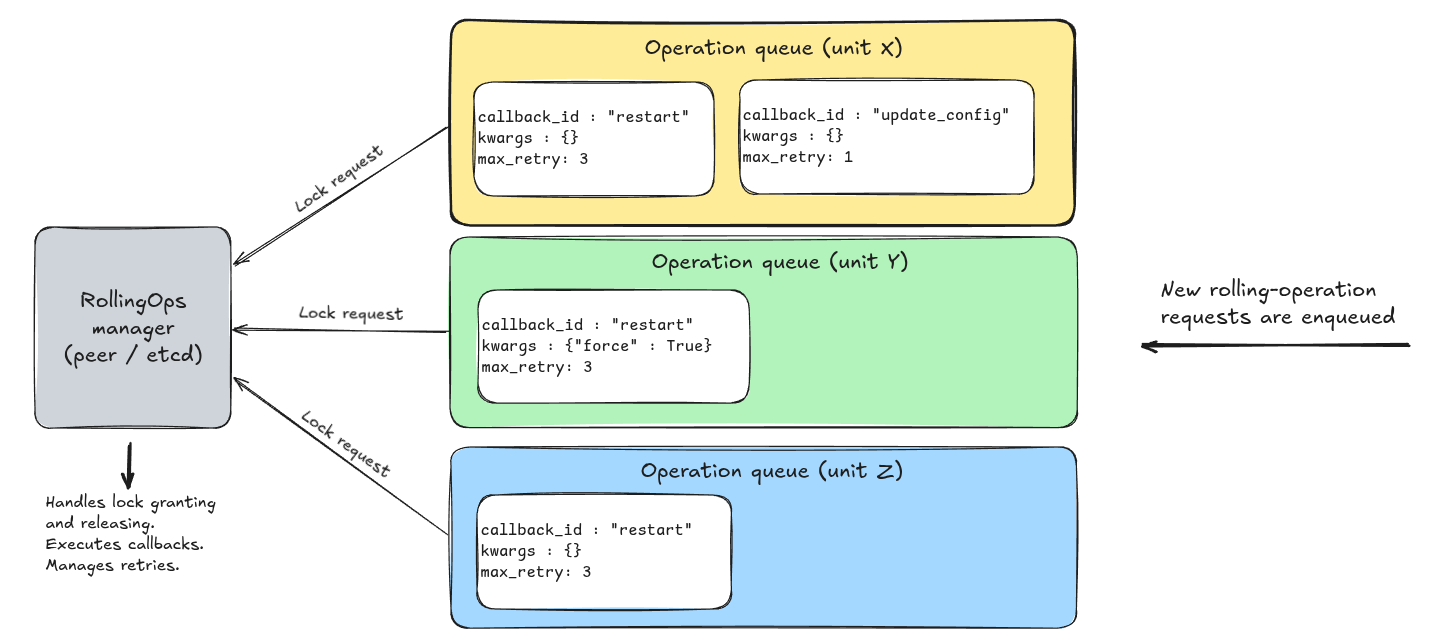

The basic idea behind rolling operations is simple: units do not run disruptive operations immediately. Instead, they request a lock and only execute the operation once the lock is granted. This makes rolling operations asynchronous from the charm’s point of view. The charm requests the operation during a hook, but the actual work happens later, when the unit’s turn arrives.
When requesting the lock, the charm unit specifies a callback, optional arguments, and an optional maximum number of retries. Operations are added to a queue which is managed by the RollingOpsManager object living in the library.

The library also performs deduplication: if the latest queued operation is identical to the new request, the new request is ignored. This prevents repeated hook executions from filling the queue with duplicate work.
