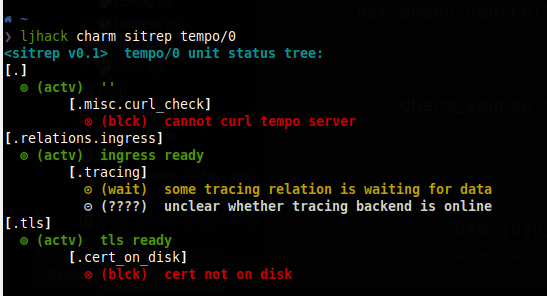

However, nobody likes reading __repr__s, so I started working on jhack sitrep, a tool to consume that repr and output a pretty-printed status report that would look something like:
<root status>: Active (message)
  - database: Blocked(message)
  -  relations:
    - ingress: Active(message)
    - tracing: Waiting(message)

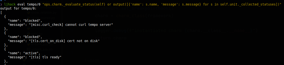

So I added a new global to the eval call: output. Calling output now json-encodes and dumps whatever you pass to it to a file on the unit. When the juju-exec call returns, jhack will scp that file out of the unit and delete it, then json-decode the data and give it back to the caller or print it out if you’re using jhack eval directly.
So now you can, for example:
and it becomes a lot easier to write scripts that wrap jhack eval to do fancy stuff such as sitrep.
The result looks like this:

Fun fact: you can add UnknownStatus instances to the collect-status events, and you can even add a message to them with a little bit of hackery:
        @StatusBase.register
        class MyUnknownStatus(StatusBase):
            name = "unknown"
            def __init__(self, msg):
                super().__init__(msg)
        e.add_status(MyUnknownStatus("[relations.tracing] unclear whether tracing backend is online"))
